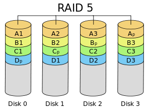

Ok I'll attempt a basic explanation of how your RAID 6 array can rebuild itself.
Lets start with RAID 5 as its slightly less complex. RAID 5 uses parity data to achieve redundancy.
So using the diagram below you can see that the disks in the RAID 5 array all contain 3 blocks of data plus an extra one with the parity data (AP, BP, CP,DP). So, if Disk 0 fails we need to recover the data labelled A1, B2 and C1. If you replace Disk 0 then the RAID controller can use the parity data stored in AP, BP, CP to reconstruct the missing data. With RAID 5 you can only lose one disk as if you lose more then you can't reconstruct the data.

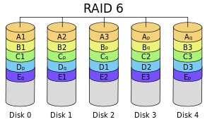

However you are using RAID 6
So you can see that each disk holds 2 sets of parity data meaning that you can afford to lose 2 disk :)
