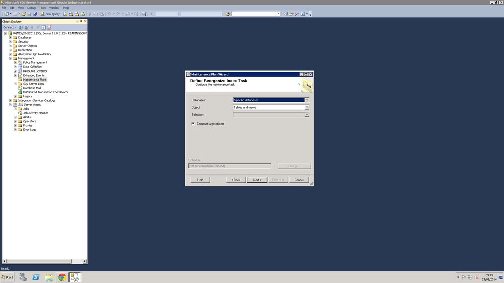

I'm convinced the problem is to do with indexes and statistics. The reindex patch doesn't update the stats.
Hint to make marks run faster: att_mark_normalised could do with some more indexes to stop RID/bookmark lookups. e.g. create an NCI on att_mark_normalised (session_start) INCLUDE person_id, mark, session_number.
I've noticed an improvement after running the following maintenance plan. Also, if you do this regularly the 100% fill factor is less of an issue.
Try setting up a maintenance plan to rebuild (not reorganise) your indexes.
Usual disclaimers, at your own risk and so on. If you're not confident with this procedure, do not proceed.
Start SQL Management studio
Expand 'Management'
Right-click 'Maintenance Plans'
Click 'Maintenance Plan Wizard'
Name you plan something like 'Reindex SIMS'.
On the same screen, click the 'Change' button next to Schedule
Set a suitable schedule (Frequency should be daily, or weekly if you prefer, at a time that fits your setup - choose a quiet time at night.)
On the next screen,
Under 'Select Maintenance Tasks', check the 'Reuild Indexes' box
In the 'Define Reuild Index task' window, choose your SIMS database(s) to reindex.
For 'object', choose 'tables and views'
On the same window, check the box that says 'sort results in tempdb', keep the box that says 'keep index online...' unchecked.
Optionally, choose to write a report to file.
Bask in the inevitable glory of a supefast system.*
*This step optional, and not guaranteed.
If you try this, please post back with your results, whether successful or not.

Apologies for quoting myself, but I've seen a distinct benefit from regularly rebuilding the indexes (not reorganising/reindexing). This also creates fresh stats so that the query optimiser can generate better execution plans.
Expand 'Management'
On the next screen,

I would say so. Our reports were practically unusable until I did this. Now they're back to normal. Not brilliant, but normal.
The plan only takes five minutes to set up. Set it to run it over the weekend and see if there's an improvement on Monday. If you do try it, can you let us know the result?
