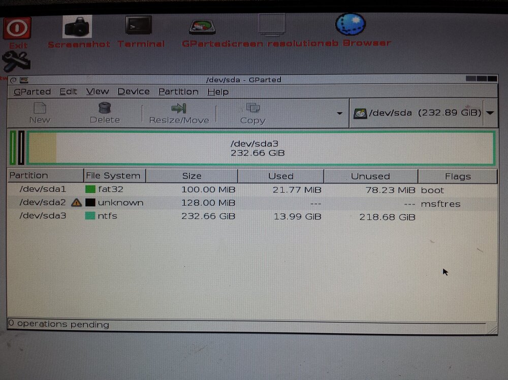

Fog keeps reporting more than 2 partitions not valid for this image type.
So I investigated using G-parted and there are three partitions
Non of our other systems running Windows 7 have three partitions
is the unknown SDA 2 partition something to do the the UEFI Bios? these are our first systems with UEFI
I did use g-parted to remove all the partitions then did a fresh install of Windows 7, Windows would boot but we still could not take a fog image and g-parted reports no partitions.
anybody got suggestions on how to fix?
We have 42 of these to set up so doing them individually is not an option.
I think this is down to EFI and Secureboot. I don't think fog supports it, as it has only very recently started making an appearance in machines and fog hasn't had an update in a while. Try cross posting this to the fog forums.

There should be a legacy bios mode you can switch to. It worked for me with laptops with UEFI and I managed to upload and deploy W7 images as normal.
On the relatively small number of machines we have with EFI, I had to disable it to image them with FOG. Not much choice at the moment, still work fine though.

Whichever imaging software you're using, you need to disable Secure Boot and EFI. Everything will work fine, as is the case with HP and Toshiba (as well as others).
Even for admins brave enough to image/deploy Windows 8 with Secure Boot and EFI enabled is creating problems.
