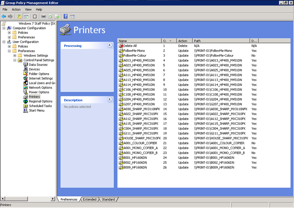

I have a Group Policy setup that consists of a number of mappings. The first setting is to delete all shared printers, then i map all other printers as update using ILT.

We use roaming profiles and have a delete all at the start of the group policy preferences that seem to do the trick...
How have you done the delete all part of your group policy preference? We have a problem where the printers are allocated to machines but the users seem to manage to pic them up and they follow them around... thinking this might solve the problem :)
Here is a screenshot of the delete all, then how we add our printers. We use update rather than create.
Ensure that you have applied hotfix KB2748246 on all of your clients - it makes group policy preferences for printing so much more reliable.
