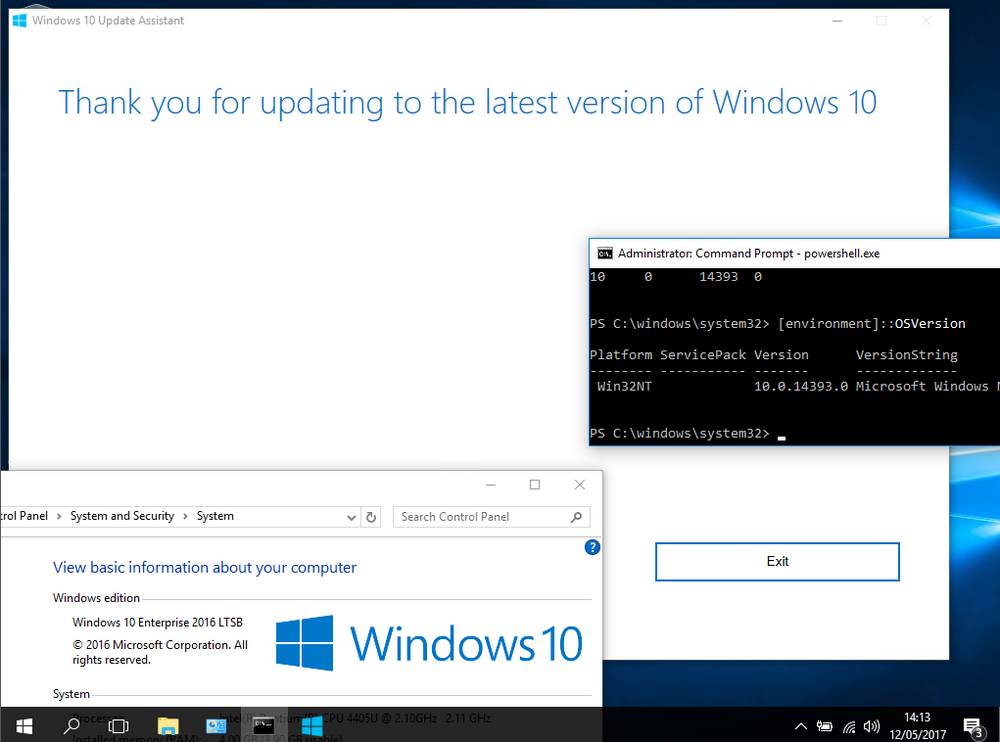

Would be good, but as noted Enterprise LTSB doesn't upgrade to 1703 yet... the upgrade helper just says it's up to date. My fault for installing the 'extra stable version for mission critical applications' /s
