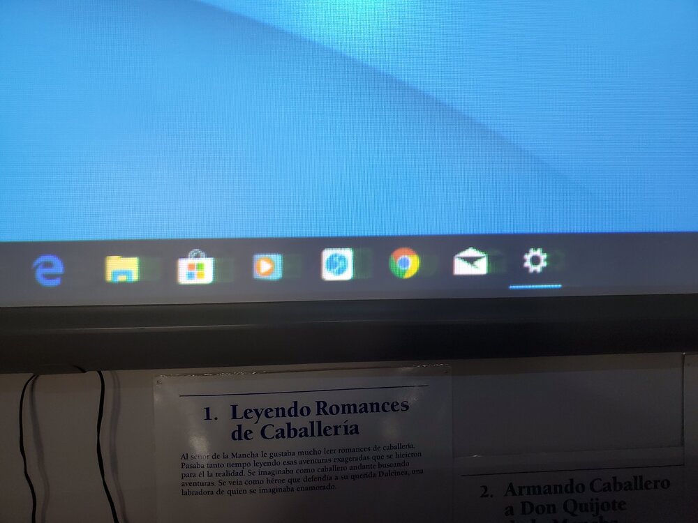

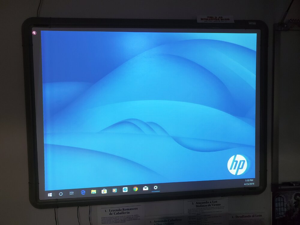

  10. I'm having this issue with this projector. See pictures below. it looks like it's displaying double of everything ever so slightly on the bottom task bar. And on the left side it has this line going down the screen. it's really noticeable on the HP logo. I was going to plug my laptop directly into the projector to see if it's a wiring issue. If that doesn't work is there anything else I can try to eliminate this issue. Thanks.

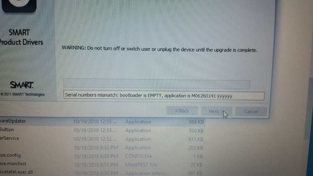

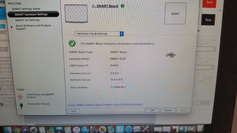

  11. I'm at a loss with this board. I have upgraded several throughout the school and when I go to update this board I'm greeted with the following. Serial numbers mismatch: Bootloader is EMPTY, application is M06260141 YYYYY with a weird line above the Y's. Also when I open up the hardware settings on the board It has no serial number. I went to another board and didn't have any of these issues. The board is still usable it just looses the orient function every so often and sometimes the pen tray doesn't work.

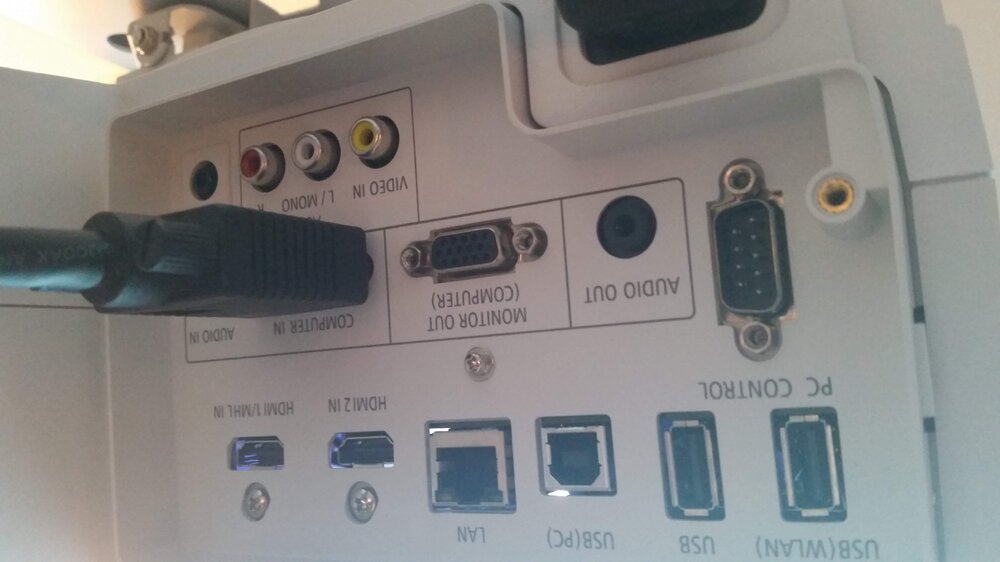

  12. The NEC Came with a mounting bracket so we just used that. The issue I found yesterday is that the Pen Tray tray has a small little connector looks like the end of a laptop charger that's attached to another serial cable that leads to the projector. I haven't tried the USB cable from the pen tray to the computer. How would the pen tray receive power I'm at a loss sorry.

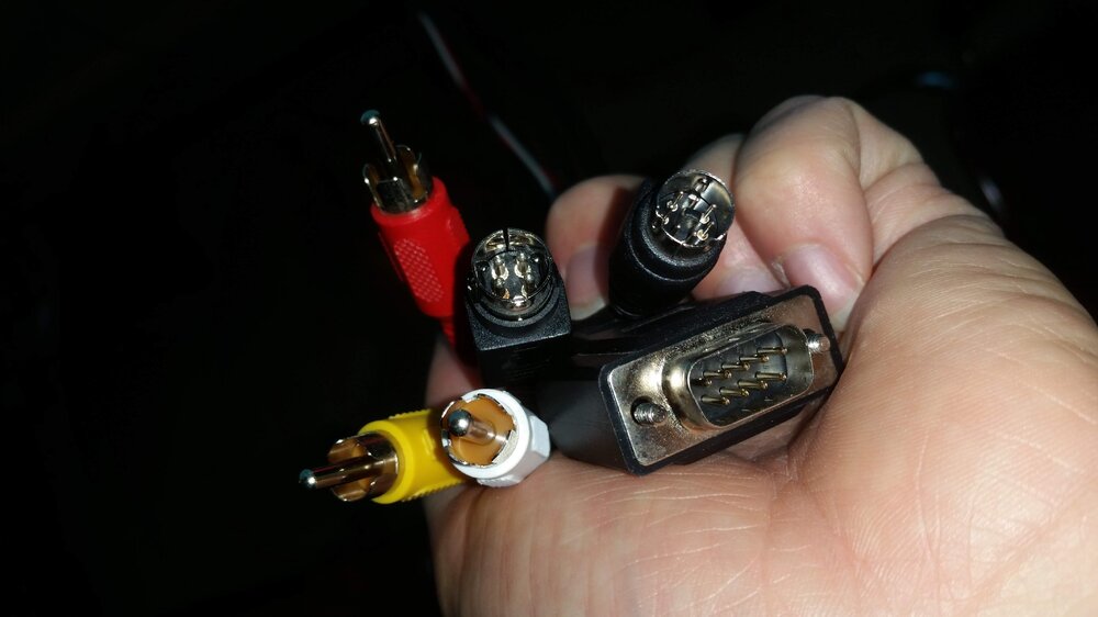

  13. We recently purchased a NEC UM361X Projector because the other Projector which was a Smart UF70 went bad. Anyway I was trying to hookup the Smart Board to this projector so the students can have touch control and I'm unable to find any of the connections that go together on the back of this new projector. I'ts leading me to believe that these are not compatible with each other. The connections I'm holding are from the Smart Board.

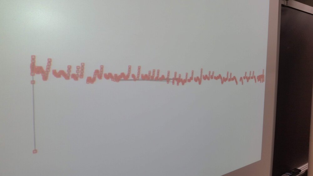

  15. The issue we are having is that when using any pen it doesn't matter which color when we start to write it or use it it goes absolutely nuts. It will not write a straight line and it appears to be really off even after a 20 point calibration. I did the trick of removing the pen tray and loosing the screws and adding a plastic washer to reduced the contact of the board and the screws but that didn't help the issue. Also I noticed when just holding your finger on the screen it moves constantly up and down. I have reinstalled the drivers already and the Smart Board says the firmware is up to date. Video of the cursor issue. https://photos.app.goo.gl/uTM5yu1YdAZUD3ft9
