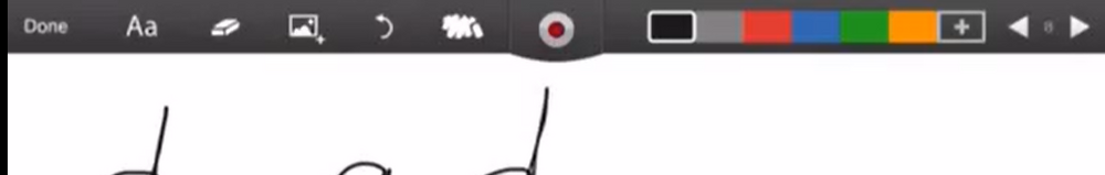

This is great! thank you for your super quick response. It makes sense that it is Showme, as they initially thought it was Showbie that they were missing. Similar name. thank you again.
Good morning, This is a bit of a puzzle for you. A member of staff used to use an app on their iPad for recording things such as handwriting to demonstrate to class. They no longer have it but cannot remember the name of it. All I have is a video of them using it and I have posted a screen print of the tool bar below.. It would be great if you can tell me what it is. Thank you in advance.
