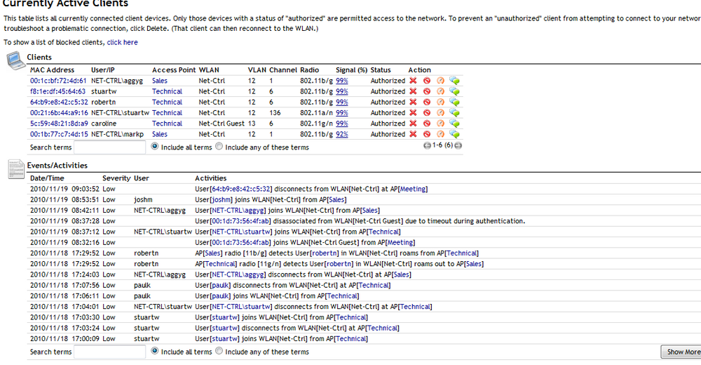

What do the client stats look like for the client on the ZoneDirector.

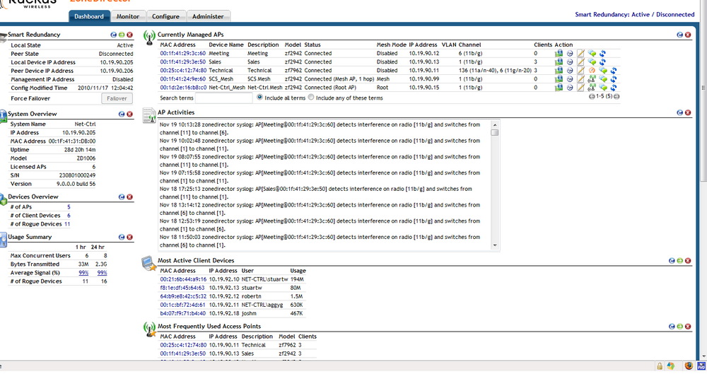

Cold you take a screenshot of the dashboard and of one of the AP's when in edit mode.

You can see that unauthenticated users will be displayed with a MAC, the client has not gone through an authorization process.
