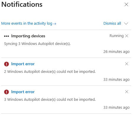

Just had a call from Microsoft who deny any issues at all, however I have just tried importing 3 hardware hashes and its now working, albeit quite slow. Not sure how much intune itself is working as I only use it for a few policies and GPO the rest. -

Ahhhh could well be related, hence when they are not declaring it a service issue at all. Still not working for me, just tried it. I have a MS support ticket now assigned, no call as of yet but they are probably sitting on their hands waiting for the official word. I would hope that MS are spinning up some instances pretty soon to increase capacity. -

Reading reports online its worldwide, yet not one mention on the official status channels. Ill keep trying till it works -

Thanks, isnt just me then Suprised no service issues been logged about it, Typically I have booked in a load of staff laptops to be migrated over and promised them back by 3pm, wont I look a wally EDIT - Looks to be Europe wide, Not able to deploy with Autopilot either - https://statusgator.com/services/microsoft-intune -
Morning all, Intune woes for us this morning, mainly on the Autopilot side. I have been unable to import hardware hashes via CSV all morning. (was working fine all day yesterday) I have also now noticed in Intune / Devices most of the data comes up with something went wrong. Anyone else seeing issues. MS support ticket logged but dont hold out much hope for a rapid response, their support has really gone down hill lately.
