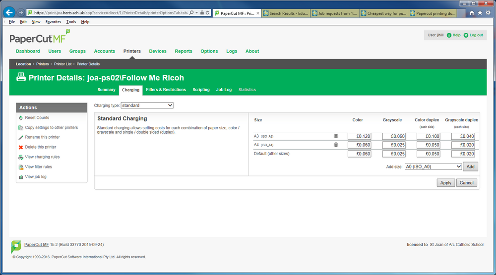

You will need to have a idea about how much printing your printers will do. If the volume of print is large enough, then a "Multi Function Device" (photocopier) gives the cheapest cost per page 1/10 that of a small desktop printer. Our printers are set to default to black and white, and duplex, if required colour and / or single sided have to be explicitly specified by the user, at time of printing. The printer / photocopier / scanner outside of my office is a Ricoh mp c5503, this device is used by our pupils.

We are using "follow me" printing with Richo MFD's and Papercut MF. For staff, every print / photocopy job has to go against a cost centre. Papercut automatically generates reports (weekly), which it emails to each budget holder, about how there budget is being spent. The follow me printing has cut down on print wastage. When you have to walk to the photocopier, before anything is printed, it helps make users think about if the need to print. We had some users concerned about others seeing what they are printing, this has receded as users realise that nothing is printed out until they are physically, at the photocopier, and have asked for that document to be printed.

I am running Papercut MF. My virtual queues are set to default to duplex, and black and white only. If users want colour, on non duplex, then they have to explicit set those setting (printer properties in the print dialogue), at the time of printing. I have to use two queues because the same printer driver will not speck to both Canon, and Ricoh MFD's.

I have configured Papercut slightly differently. Pupil get a weekly allowance, the amount depends on which year they are in (with a maximum accumulation of 2 weeks). The finance manager get a automatic monthly summery of the pupils printing costs. Staff have to select a cost centre (department) which is charged for the printing/photocopying. Department membership comes from AD groups, and is automatically set by the AD sync feature. Heads of department get a automatic weekly email report, giving a summary of who has spent there budget. It is the responsibility of the head of department to manage there budget (some HODs have asked for a staff printing quota). The finance manager get a automatic monthly report for each departments costs. Papercut was set up this way so that staff who are members of multiple departments, only have 1 login. Because we are using "follow me printing", and all users have to physically go to to the photocopiers, and then login to get there printing, this has reduced wastage.
