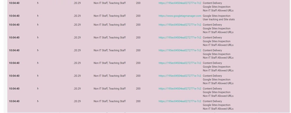

Smoothwall: Realtime webfilter questions
ThomL replied to browolf's topic in Internet Related/Filtering/Firewall
Hijacking the thread slightly - I've got a ticket open with smoothwall currently that's just been escalated from 1st to 2nd line - 1st line said the issue is certificate pinning from the ClassCharts iOS App, red items with a 200 in the real time: Escalation followed me asking how I could determine certificate pinning issues in the future to save opening support tickets - is it as simple as items being displayed in red while showing a 200 have a certificate issue? -
