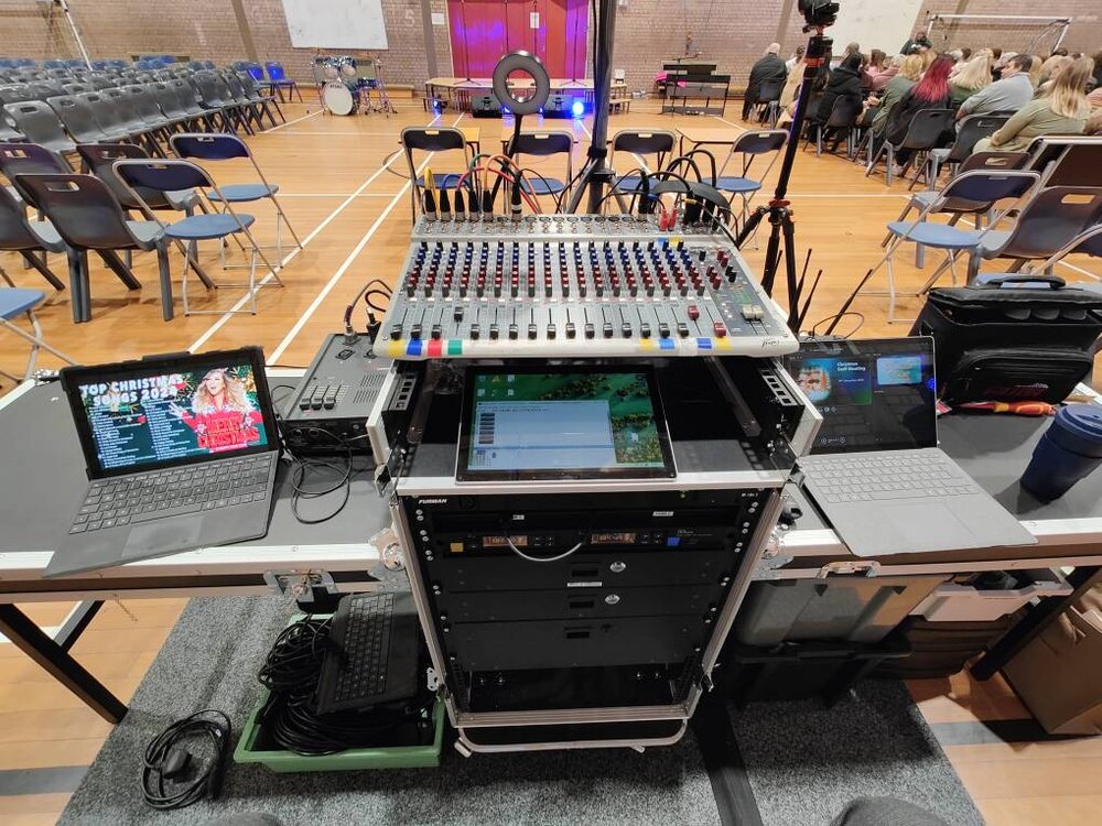

  3. We have two projectors (left and right), in shock absorbing cages and wall mounted screens. Each projector has a ScreenBeam wireless Display, and a HD-T connection back to a HDMI matrix, in a cabinet in the store cupboard. The HDMI Matrix controls the third ScreenBeam (to run both screens together) or extra connections for HD-T from the back of the hall. The AV cabinet also has the Amp and zone mixer which feeds the high level speakers, with wall mounted zone controllers for each side. The setup allows two classes to be in the hall, or one teacher to run both screens by changing the input on the projectors. The sound follows the Projector source. When we run performances, we run a desk mixer with Mics, Instruments etc into the Zone Mixer Via a multicore wall box, and hardwire the screens through the HDMI Matrix via extra HD-T connections in the same box (multicore and cat6 have Ben run "front" to "back" over the rafters). Gives us simplicity for the teachers and flexibility for Performances. The screens have been robust, although the projectors do need realigning every year or so.
