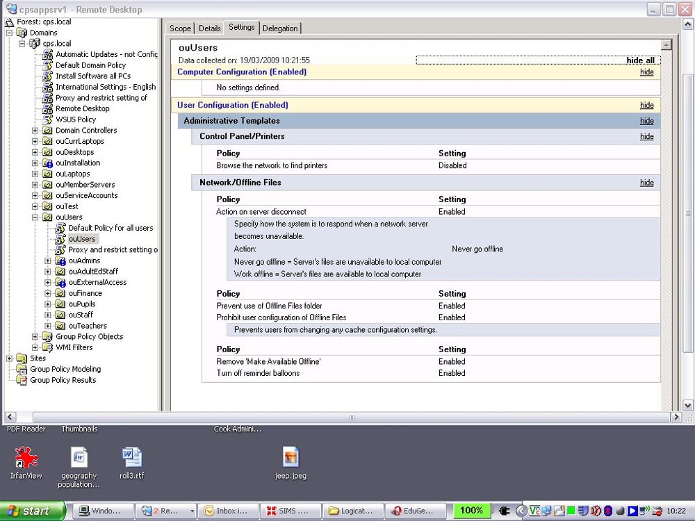

Thankyou all, I think it's fixed now I did need the admx files and to install GPMC.msc on a vista PC (guide here: http://www.edugeek.net/forums/windows-vista/3706-vista-w2k3-domain.html) but as SP1 took away the admin tools, I also needed to install them again first (Installing GPMC on Windows Server 2008 and Windows Vista Service Pack 1 | Vista Home). Once that was done, I ran GPMC.msc and found reasons for all sorts of annoyances that had been surfacing on the Vista workstations, and certainly stopped the troubles offline files were causing. Now that's what I call a day's work, no more silly green circles with arrows in them -

I think you may have hit the nail on the head there - just testing now Almost that's spot on for the XP machines... now is anyone going to tell me why it doesn't work for Vista?? That's a damn good point too, the backup server can be a bit slow witted - It has definately updated since the policy was written originally but I'll make sure my tweaks this morning have replicated On this occasion, I can confirm that FRS does appear to be working correctly. But good call! -

I think you may have hit the nail on the head there - just testing now That's a damn good point too, the backup server can be a bit slow witted - It has definately updated since the policy was written originally but I'll make sure my tweaks this morning have replicated -

Thanks both It's been there a good while, like at least a few months. I did just gpupdate /force, just in case, but no cigar You mean in the "caching" button? I Just checked that and one of them was set to be available offline, so I've fixed it (and logged out and in again) and the little "sync" arrows are still there I just want to turn it off, everywhere, forever! -

This nearly went behind the red door as it's driving me nuts, but I decided to put it here so that I can thank anyone kind enough to help properly. Ok, breathe.... What do I need to do, in group policy, to finally turn off ALL offline files and synchronisation EVERYWHERE?! If a network connection's not available, for whatever reason, I want the user to get a message saying that something's gone wrong, like in the good old days, so they know they need to do something, rather than windows (XP and Vista) pretending to have saved it ok before losing the work when the user's roaming profile doesn't save properly either! I've attached a screenshot of the GPO concerned - can someone please tell me why the i'm still seeing little "synchronisation" icons all over the place, it's supposed to be turned off for sake! any help greatly appreciated, many thanks
