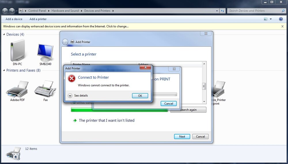

  4. Still having terrible problems with this, it won't even let administrators add / remove printers. I have started adding printers via GPO to get us by, however a lot of them say 'Driver Update Needed' when allocating out via policy.

  12. Anyone? This is causing a bit of a nightmare at the moment. Users are getting the pop-up above and can't install printers as they are not an administrator or this error when trying to add / remove printers. It worked perfectly in my last school on Server 2008 when point and print policies were available.

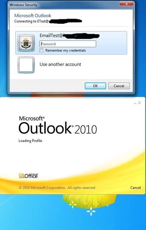

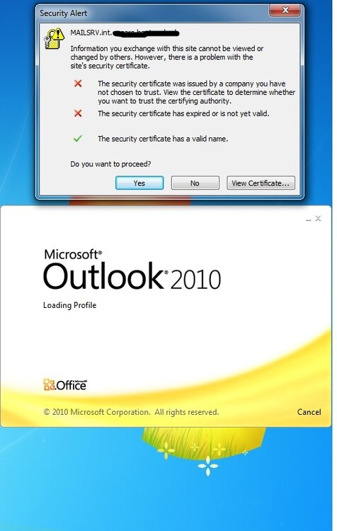

  14. Dear all, We have two Exchange servers running Exchange 2007. One of them is no longer picking up new users added to active directory so we unable to setup new mailboxes on this server. On the second server, you can see the new users and give them a mailbox, however outlook refuses to add the account and says the name cannot be found on the exchange server that has the problem. Any ideas? Screenshots of each error below: Some existing users are getting similar pop-ups, others are fine!
