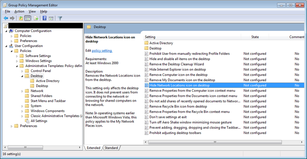

FN-GM replied in post number 4 that it was the desktop icon he was looking to remove, or at least that is how I read it.
