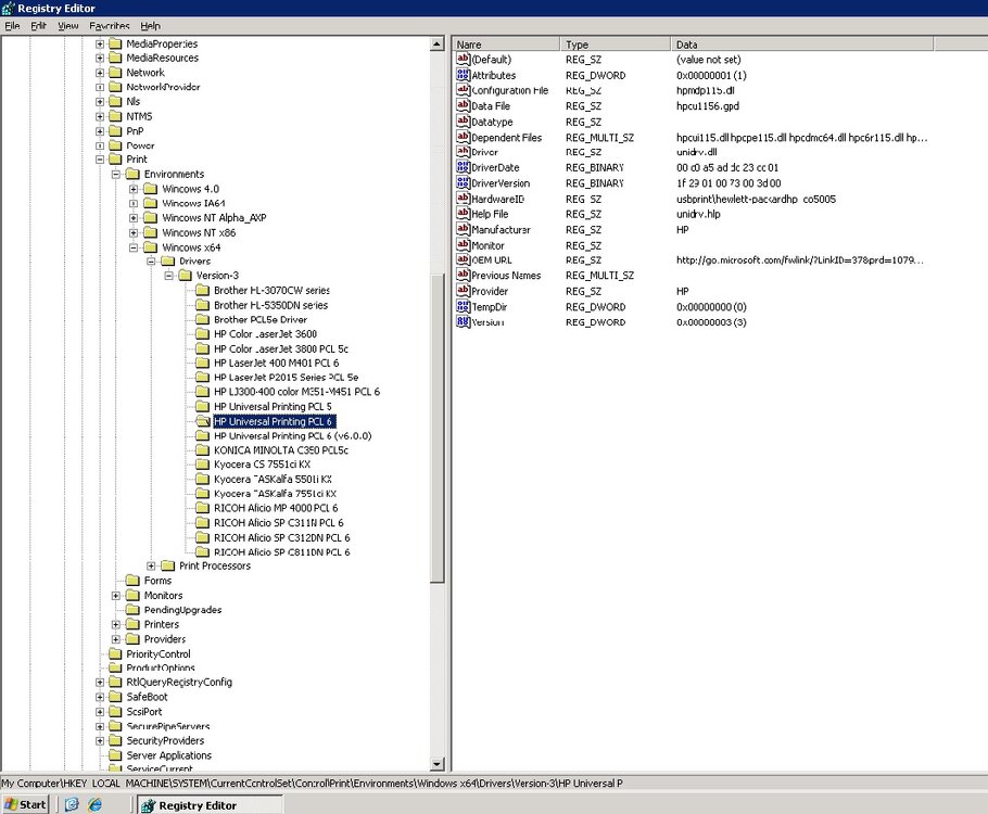

  4. Thanks for this but my drivers are all odd numbers already. Really losing my patience with printers now! Any other ideas?

  6. Interested in this registry fix. I am still having problems with deploying printers. My drivers are correctly signed, I have point and print disabled, tried manually installing drivers first, tried logon script, computer gpo, user gpo. I get users report that no printer has been installed whatever I do! Anything else I can try?

  24. It is a 2003 server yes. I have however been receiving the prompt to install the driver since installing the update despite having my point and print restrictions set to to disabled.
