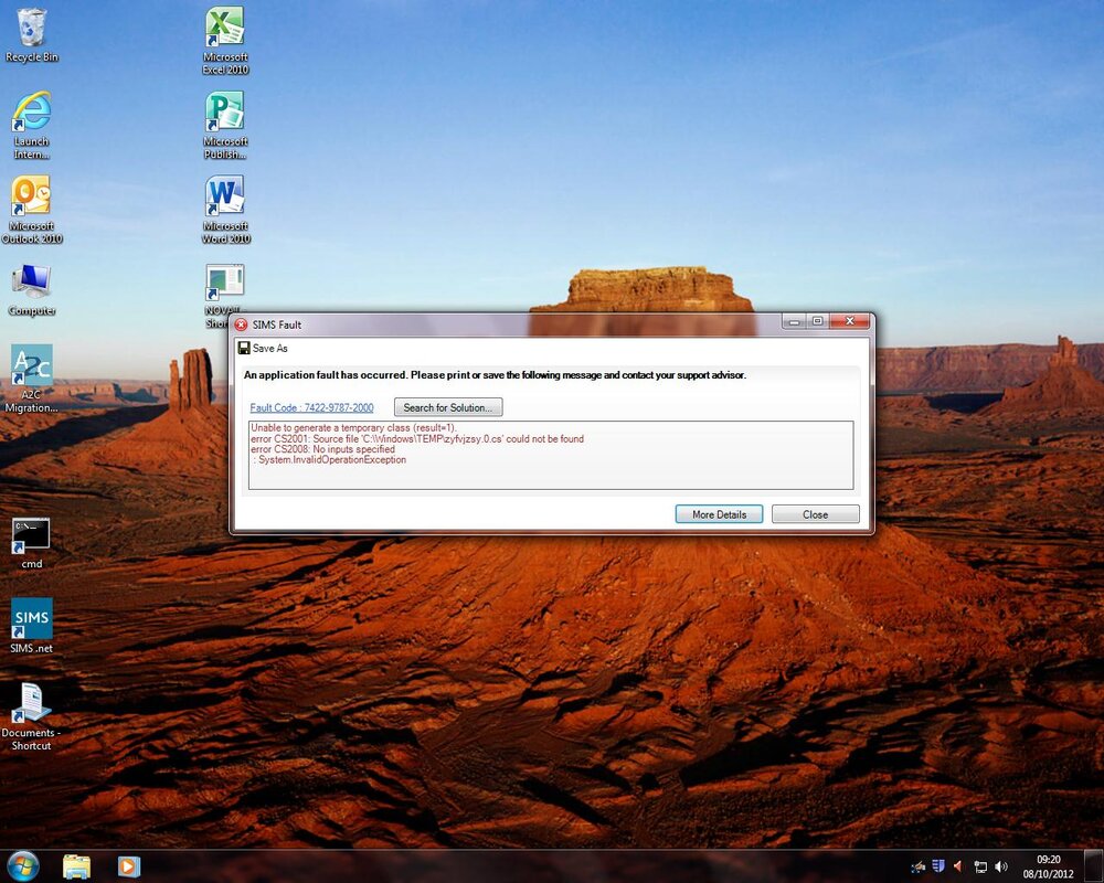

This fix was working fine however I'm now recieving this error. If I change the temp path back, I don't recieve the error. This error is with sims.
