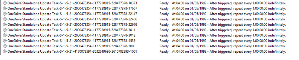

  17. for some reason I have lots of those update tasks.....
  18. Can anyone advise how to disable the Windows 10 'Microsoft OneDrive' app notifications (via GPO?). I think its installed as part of Windows, I don't feel like uninstalling it as I feel it may become a part of work/school life at some point whether we like it or not, but I don't want users to have 'Onedrive needs updating' messages when they login... Solution for lots of machines.. Thanks
