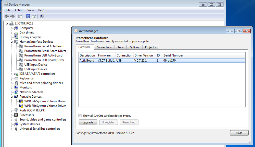

steve Posted August 22, 2011 Posted August 22, 2011 We have just deployed our new Windows 7 image to all our student computers and are having problems getting our Promethean boards to work. The ActivDriver has not been deployed as part of our image and is being installed manually on PCs with the board attached. On the 3 PCs / boards we have tried so far the board is recognised but none of them will successfully calibrate the board. On each board the cursor will stay in the bottom right of the screen (over the Show desktop button). We have tried various versions of the driver (5.7.22, 5.7, 5.5) and none of them work. I've also tried one of the machines in safe mode but the same error occurs. Anyone seen this before? I'll be trying a different computer on these boards in the morning.
steve Posted August 23, 2011 Author Posted August 23, 2011 More info - Tested one of the boards via a Win7 laptop with same driver version and it works fine. Only difference I've seen between the laptop and new imaged desktop is that the desktop has also picked up a second USB driver. The Promethean USB Board Driver isn't present when connecting via the laptop, but on the desktop (screen shot below) does have this.

steve Posted August 23, 2011 Author Posted August 23, 2011 Hi Steve, It could be that you have 2 instances of the ActivDriver installed (one being much older and hence causing a conflict) You say that you are manually installing the driver but before you do so is it possible to check if there is an older version installed on the image? Have a look if ActivSoftware\ActivDriver folder exists in Program Files or if a process called ActivControl is running in Task Manager. @TRobinson thanks for the reply. I've checked another PC from same image and it doesn't have that folder, or that process running. I also tried attaching the board to this machine and it doesn't identify the drivers for the board. Both the USB drivers show in the image above show the 5.7.22 driver version. What I mean by manualy installing the driver is running the exe from the promethean site.
