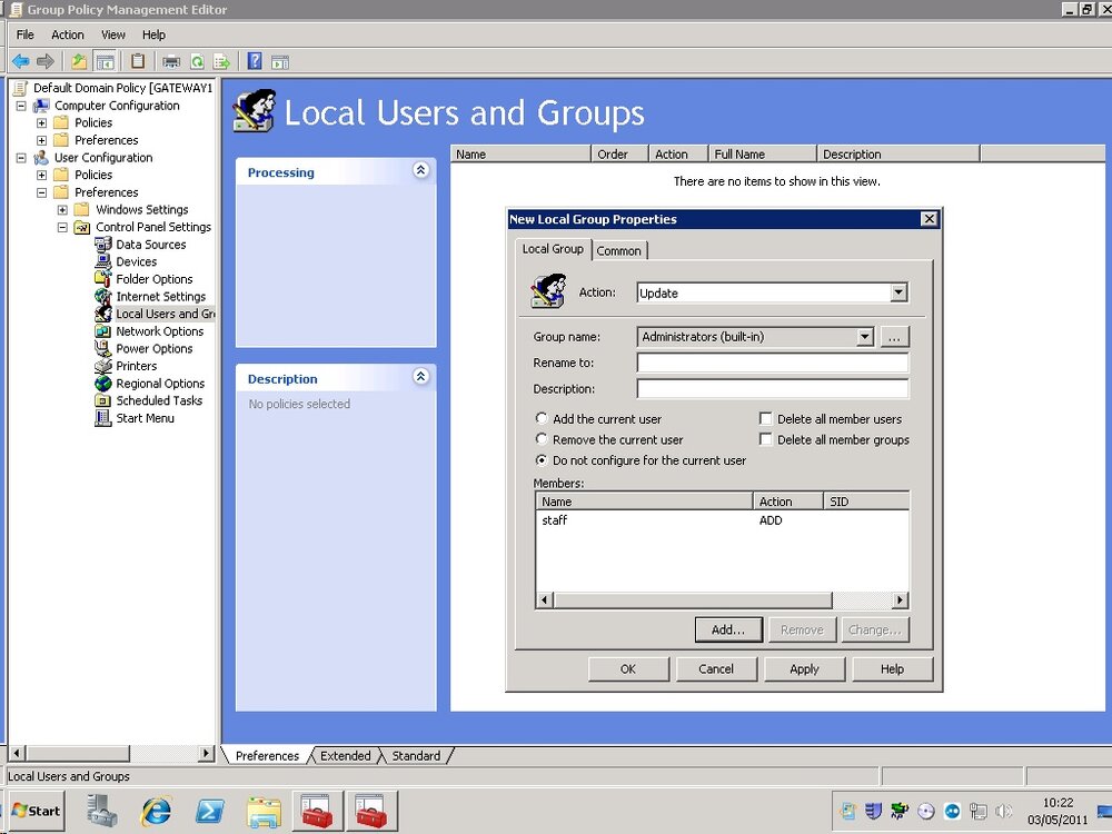

sted Posted May 3, 2011 Report Posted May 3, 2011 if you have an 08/08r2 server you can do it via group policy preferences rather than via each pc and an mmc

witch Posted May 3, 2011 Author Report Posted May 3, 2011 If I put the students as local admins, wouldnt that mean that they could change all sorts of things on the machines? Not something I want!
Michael Posted May 3, 2011 Report Posted May 3, 2011 If I put the students as local admins, wouldnt that mean that they could change all sorts of things on the machines? Not something I want! Not if you're clever with your policies. Hiding and denying access to C:\ is a must however.
sted Posted May 3, 2011 Report Posted May 3, 2011 id just try it with 1 user and see if that helps i wouldnt want to do it for pupils its just a policy i usually use for staff laptops so they can install their own printers etc without bugging me
