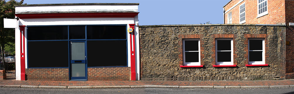

Im doing a job with my dad for a client of his who is an estate agent who is just about to move into new premises. There is a 46" screen going into the main window to display the latest properties etc. There are also 3 smaller windows to one side and he wants a 24"/26" in each and the data scrolling across all 3 (picture attached of shop frontage).

i want the 3 screens to act as if they were one big screen with the data sliding from one to the other. eg if the screens resoulutions were 1000 wide, the slide would be 3000 wide with data coming from left to right.
ATI's Radeon Eyefinity range of graphics cards support multiple monitors acting as one - they have some cards with 3 (or, indeed, 6) DisplayPort outputs, one of those should do nicly.
