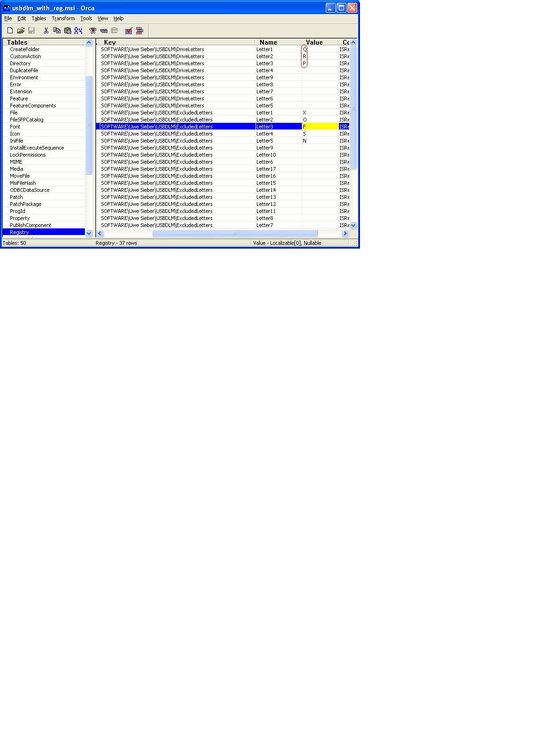

box_l Posted September 30, 2008 Report Posted September 30, 2008 (edited) i am still using this version i hacked to apply the drive letters in the registry. its an old one but it has never let me down. drive letters are P: Q: R: but you can edit them if you open the msi with orca go to the registry table, sort by key and just change the letters to ones of you choice. further down the table is a section for excluded drive letters (your mapped drives) hope this helps BoXusbdlm_with_reg.rar Edited September 30, 2008 by box_l 2
