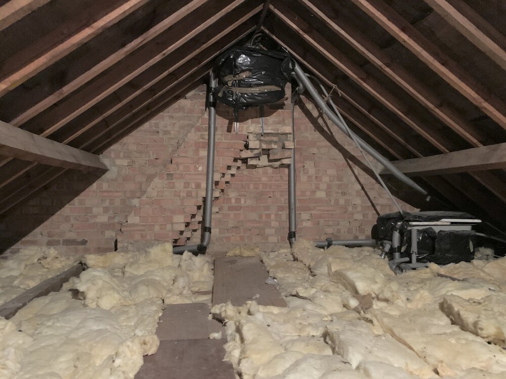

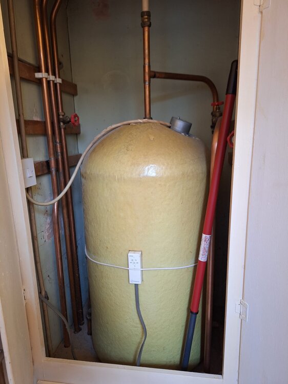

I am now faced with a massive oil tank in the garden linked to a 20 year old oil fired boiler for central heating and a small immersion tank for hot water.
On one viewing I looked in the loft and was faced with the following...
What the hell are these for!!!!

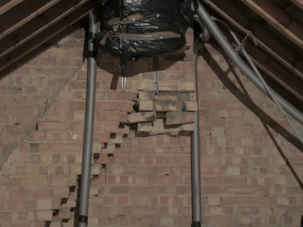

Try and ignore that the top one looks like it's held up with shelf brackets attached to a chimney breast...
I certainly hope none of these are attached to a tap that I have to drink from...
EDIT: Oh and don't mention the fact that one of the chimney breasts has been removed and doesn't appear to be adequately supported (in fact just had some bricks and mortar thrown at it) and has a water tank hanging off it (rather sore point as is much of this ridiculous farce of a house purchase which I won't bore you with)...

Yet I suspect you paid a pretty sum for a surveyor whose report was full of weasel words to prevent you from suing them for basically doing the housing equivalent of walking around and kicking the tyres.

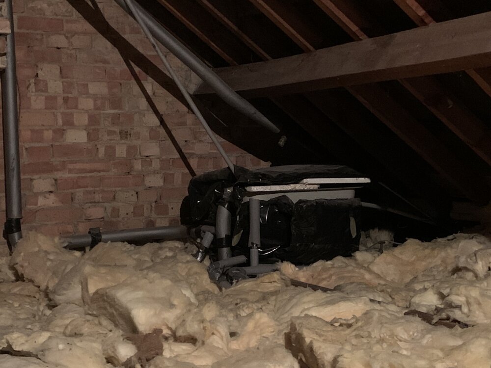

Header tanks. They provide constant pressure for hot water and heating system. Don't drink or fill cooking water from the hot tap!
This is why England has seperate hot and cold taps; to the utter bafflement of Americans. (Our houses are often older than their country)
Both of them?
From the link @mavhc supplied I did wonder if one them was to do with the 'hot' and one of them for the 'cold'...?

There's also a pipe running down from the left of the tank on the chimney that appears to run down into the living room and disappears behind the open fireplace...? Primitive back boiler?
EDIT: I didn't even notice until I looked at the pictures just now that on the right hand it appears one of the pipes is held up with rope tied round one of the roof A-frames...
The cold water tank is to provide (some) pressure for your taps. the heating tank is to provide expansion room so that if your boiler or tank has a technical issue and overheats your tank doesnt explode killing you and your family. (has happened).

The high tank is for hot water and the lower tank for heating.
So when you say the high tank is for hot water, this feeds into the immersion, or does the immersion feed into it...?
The cold water tank is to provide (some) pressure for your taps. .
So do we have a consensus if one of these is for cold water or is one for hot water and the other heating?
The smaller tank basically acts as an expansion vessel for the boilers heating loop that runs through the cylinder and radiators. It's known as a feed & expansion tank or F&E tank. Recently had to figure out how my system worked, which was quite confusing initially as I have an unvented cylinder but also have a vent pipe :)

Do you only have the immersion heater for hot water, no feed from the boiler to the jacket around the tank?
It all looks antique and basic enough that you'd benefit from a complete refresh, along with getting some some insulation in your roof across the joists. IMO, don't have cavity wall insulation fitted - houses of this age can often end up very badly damaged by the resulting damp issues. Air gaps in cavities work very well for insulation.
I'm not sure really, we haven't moved in yet so I haven't gone in and started doing a thorough investigation. There's a lot of pipework (and quite a few pipes in the immersion cupboard - first picture in OP), but I've no idea where they come from, or where they go to... Edited by Koldov
It looks similar to our system where 1 is the expansion tank for the central heating loop and the other is to provide additional head pressure for the hot water (water goes from the tank to the immersion/hot water cylinder where it's heated before going to the taps). In some systems it's also used to feed the upstairs (bathroom) cold taps.
Yep, little tank keeps the heating loop that heats the Radiators and Hot water cylinder coil filled, and allows for said water to expand when heated.
Big tank fills the water in the hot water cylinder, and provides pressure for the hot water. if you open a hot tap it will be water that was in big tank that comes out. Lovely!
Until we had it replaced with a sealed system and ASHP, that's what was in our loft. Without seeing the pipe runs, I can't be certain this would be true for this installation system, but....
That tank also fed the cold taps other than the kitchen sink, which was the only drinking water supply in the house. So that's what you brush your teeth with [emoji16][emoji1785]
