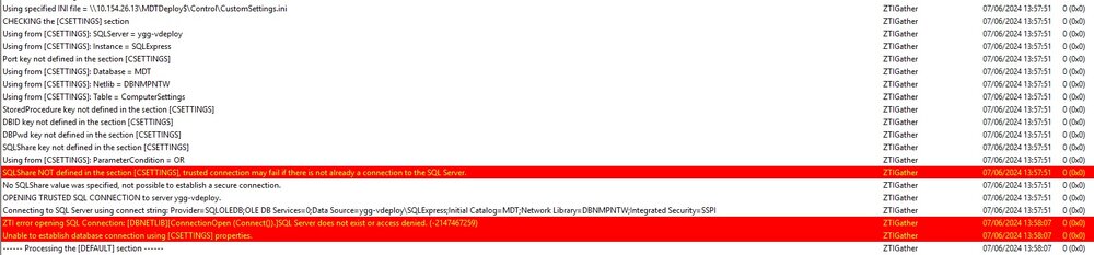

Here is a picture of the logs - Don't mind the server name in there. Not sure why it cannot connect to the SQLShare - nothing has changed. It's all setup like it was.
[ATTACH=CONFIG]71665[/ATTACH]
HOw does one set the SQLShare name? It says in MDT to set it as the Deployment Share path - so I'm sure that is what we always did.
Gareth

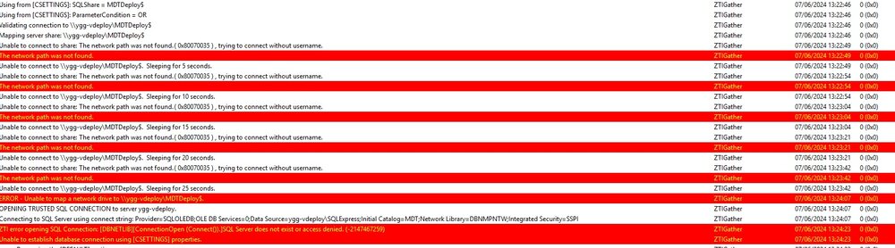

Going back a step, with those 0x80070035 errors, can you manually browse to the share/ping the server etc from the client while it's building/breaking? (Assuming it hasn't changed in MDT it's like pressing F8 to open a command prompt during the PXE).
At least that way you'd be able to confirm things like DNS is happy, drivers are connected to check network connections, does it resolve the hostname etc, does the account let you manually log into the share by just entering the credentials you're using etc?
Might not be anything SQL side if it's not even finding the machines due to a missing NIC driver/DNS issue etc
Steve
The errors before the attempt to connect to the database are likely where your issue is. Those log entries say that it's trying to connect without a username. Are you expecting that? I'd have thought you'd be providing credentials for the client to access the deployment share.
We don't put the user creds in the bootstrap.ini file. WinPE will then prompt for credentials when it first attempts to access the share. That's how we do it, to prevent anyone other than us from initiating imaging.
Okay - we are connecting to the share. Latest build showed 2 errors. With Named Pipes we've never had to enter credentials. I can add then if I need to though. Here is the latest log. I cannot understand what would have changed recently to cause this.
I'll add the credentials to the database and go from there again.
GJE
I think the credentials are for accessing the deployment share as a whole, rather than for the database as such.
I think you're missing the "SQLShare" parameter in your CSettings. This is the CSettings section from our deployment share rules:
[CSettings]
SQLServer=MDTServerName
Instance=SQLEXPRESS
Database=MDT
Netlib=DBNMPNTW
SQLShare=DeploymentShare$
Table=ComputerSettings
Parameters=UUID, AssetTag, SerialNumber, MacAddress
ParameterCondition=OR

I had that in there but took it out at one point. Are you putting the name of your share in there? Our share name is MDTDeploy$ or are you putting in the words 'DeploymentShare$'. It's clearly a permission issue somewhere.
Gareth
