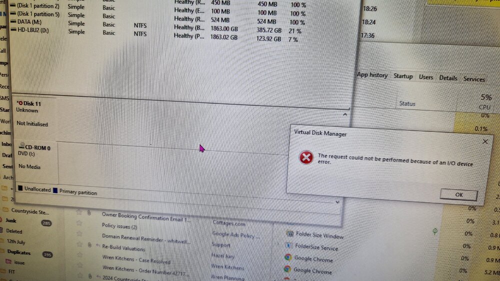

I have a Samsung HD501LJ 500Gb Hard drive that will not be read
Here is the clicking video
https://www.dropbox.com/scl/fi/bt2b54565fx7y4h99aziz/2024-05-19-14.24.35.mp4?rlkey=cdg2d5687azhi3ub5wqawi1hv&dl=0
The computer will beep as you can hear in the video but is not recognised and it will not initialise
I have an exact same working model and have swapped the outside circuit board and also the inside arm and magnet to no avail...
Any suggestions ?!

So I am guessing the problem lies with the Platters, as I have replaced everything else.... ?
But it still clicks

As you have replaced everything else, the likely cause would indeed seem to be a problem or problems with the disks. Bad sectors, maybe, with the clicking noises coming from repeated attempts to read the affected area(s)
All indications are not positive.

The drive's dead for sure. If you put it in a freezer overnight, you might have enough time to be able to get a partial image from it if you are lucky. I've seen that work and not.
Yeah, the clicking is indicative of a mechanical hardware fault. I’m guessing that if you had backups you would not need to ask.
DMJ’s suggestion is a good one but if it’s a lot of data and you really need it then I’d be contacting a data recovery company
Clicking drive and no initialization defo sounds like the drive is near dead. You might be lucky and clone it to a new drive but not guaranteed I've managed that once when a field engineer and as a last resort.
