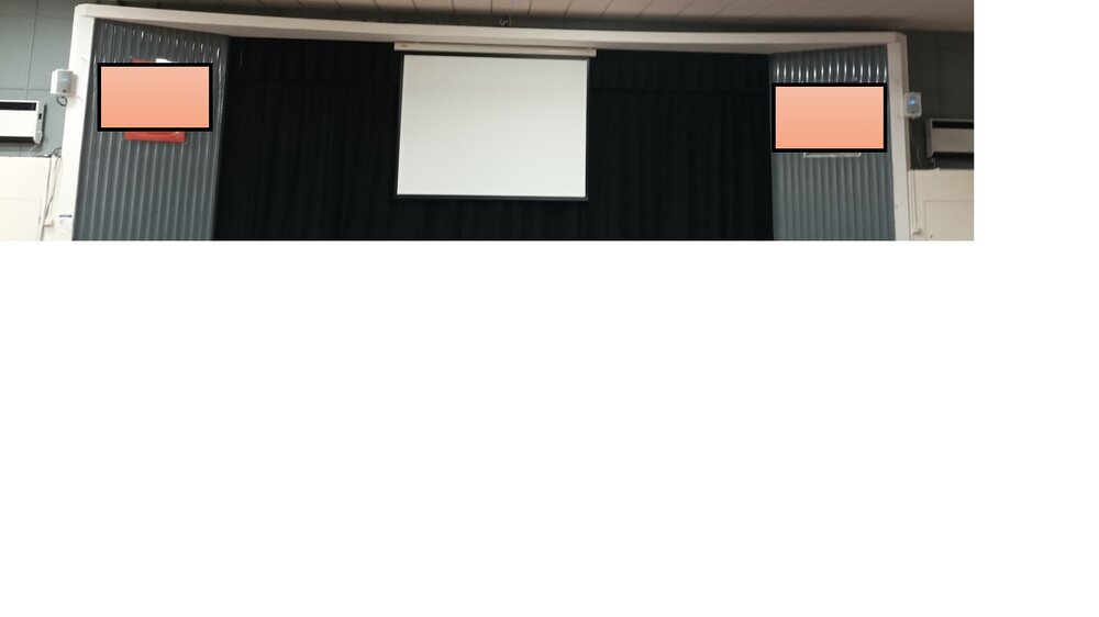

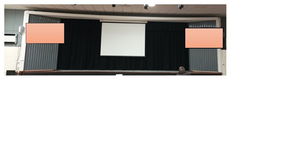

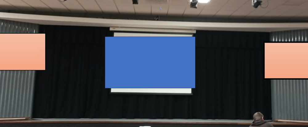

This is my rough attempt at some maths - showing how large a 75" screen would be - compared to the size of the current screen....
Obviously it's hard to tell without knowing what's actually there. But I would assume that's something like a 120inch 4:3 screen? Which would be around 2.4m * 1.8m
If so those TVs are too big in comparison - as a 75inch 16:9 would be around 1.6m * 0.9m (viewable area wise), so 2/3 width and 1/2 height compared to a 120
Rough example as per your pic:
Do you know the size of that drop down? as obviously could be bigger or smaller :p
Steve
