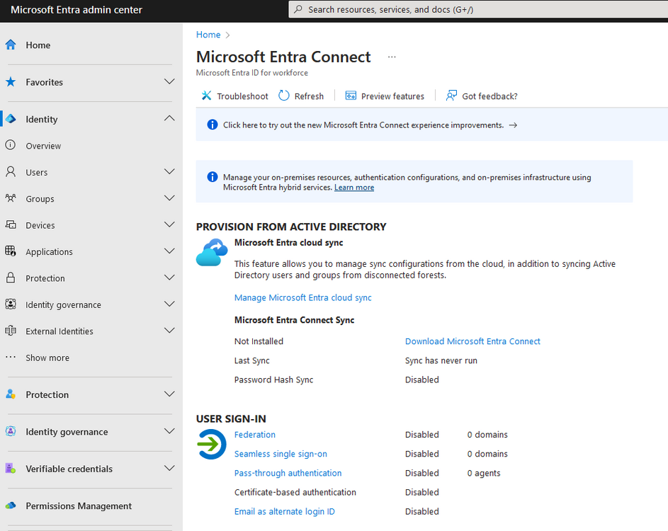

I am still struggling to find a way that will allow passwords to be set and fixed en masse. It looks like I should be able to use Azure AD/Entra ID to sync our on premises AD to achieve this, but I'm not sure if this is an extra cost. Anyone know?

It looks like you need Server 2016 or later for this anyway (don't judge), so we'd need to upgrade the server(s). I'm pretty sure that I can't just use a 2016/19/22 iso to do this as we probably need to pay for an upgraded license - or do we?
I've bulk reset a lot of password in the past month.
Done it in AD and then let the sync happen.
That's what I want to happen, but haven't got the connect set up and don't want to set it up and then get a bill!

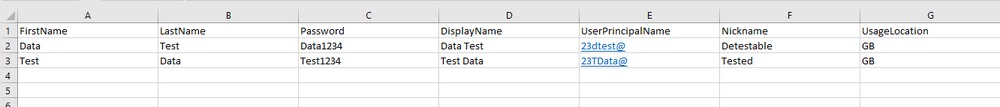

The code below assumes you have got to stage where you have imported your csv from the first site above. However the csv needs the following information at a minimum. You can add other fields if they're recognised, but this has everything we need (and more, in the case of Nickname/Alias). KS1/2 so they have fixed passwords or it would have been a much simpler "upload a csv as provided in Exchange Admin".
UPN=Full Email Address e.g. [email protected], Nickname=Alias (doesn't like spaces - I just concatenated first and last names in the non-test version)
