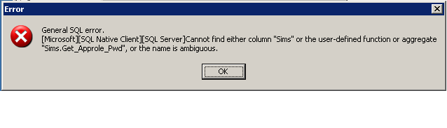

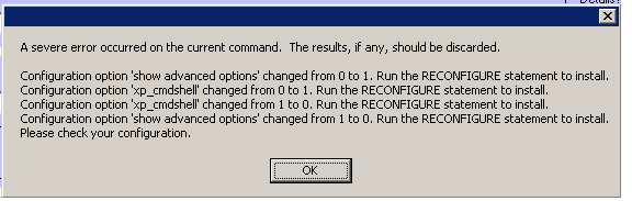

Sylv3r Posted July 20, 2008 Posted July 20, 2008 I have succesfully moved my SIMS database to a new server and can log on succesfully by I am having issues with moving the FMS database. When I try to attach it on the new server I get the following error message (error.bmp). When trying to logon to FMS I then receive the next error message (error2.bmp). Does anybody have any idea what the issue maybe? The database reattaches fine on the old server with no error messages and I can log on fine. Thankserror.bmperror2.bmp
Oops_my_bad Posted July 20, 2008 Posted July 20, 2008 I have succesfully moved my SIMS database to a new server and can log on succesfully by I am having issues with moving the FMS database. When I try to attach it on the new server I get the following error message (error.bmp). When trying to logon to FMS I then receive the next error message (error2.bmp). Does anybody have any idea what the issue maybe? The database reattaches fine on the old server with no error messages and I can log on fine. Thanks Are you using SQL express? I always got the first error message when attaching the SIMS database to an instance I setup using the MS install of SQL Express. As soon as I setup a blank sims database with the CCS release of SQLE and attached the SIMS databse it worked fine.

Sylv3r Posted July 20, 2008 Posted July 20, 2008 Are you using SQL express? I always got the first error message when attaching the SIMS database to an instance I setup using the MS install of SQL Express. As soon as I setup a blank sims database with the CCS release of SQLE and attached the SIMS databse it worked fine. Nope using Microsoft SQL Server 2005.
Oops_my_bad Posted August 9, 2008 Posted August 9, 2008 If the FMS database doesnt attach and produces that error, close dbattach on the new server and open it again. Detach the FMS database (probably ccsfms) and re-attach it. Should work fine the second time (same thing sometimes happens with the SIMS database too)

Sylv3r Posted August 9, 2008 Posted August 9, 2008 If the FMS database doesnt attach and produces that error, close dbattach on the new server and open it again. Detach the FMS database (probably ccsfms) and re-attach it. Should work fine the second time (same thing sometimes happens with the SIMS database too) I had another look at this yesterday and managed to sort it in the end by running simssqlapplication.exe again. Thanks
