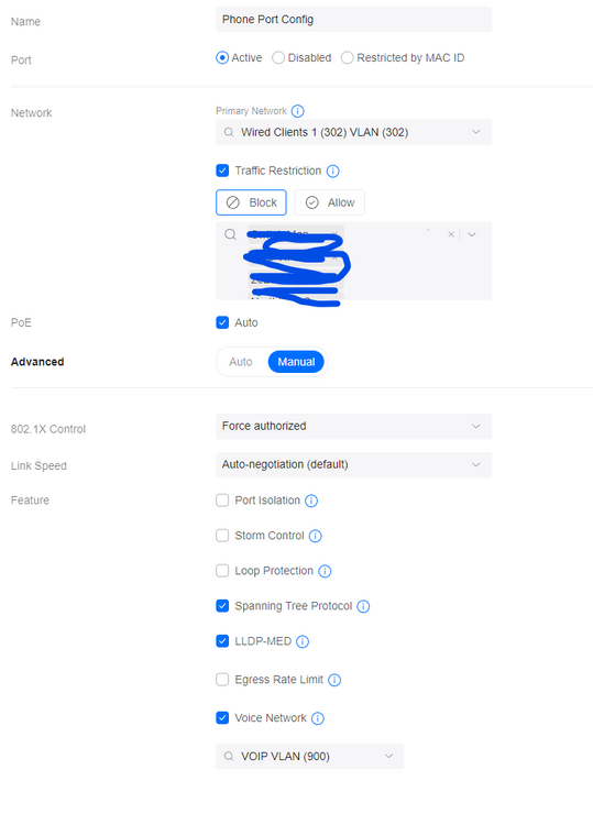

They are, and the VLAN is set up for Voip as far as you can with Unifi switches.
I use Unifi switches but I have a different switch make for the core doing the intervlan routing (HP Aruba) if you have a different switch that is doing your layer 3 routing, check there for it to also be set as the voice VLAN.
I also made a config profile for Phone Ports, where the default is the wired VLAN and it has access to the voice VLAN, making sure the VLAN ID is set on the Phone for the phone itself (as then you can use the passthrough for PCs) and declared the Phone VLAN for the Voice Network there too.
[ATTACH=CONFIG]69780[/ATTACH]
That's exactly how I have it set up.
