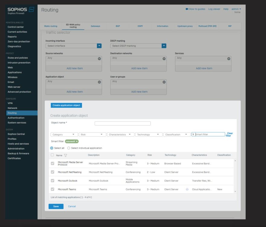

Pretty sure you can do this with Sophos XGS and they have a home SW version which is free https://www.sophos.com/en-us/products/free-tools/sophos-xg-firewall-home-edition/software

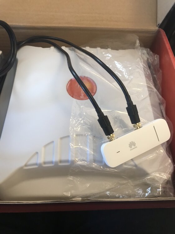

I did some wandering today with my comically oversized 4G antenna attached to a tallish pole and to my dongle, plugged into a laptop. I managed to get 13mbps out of it on EE. I'll have that!
Called a television aerial company today to ask if they could attach the antenna to an existing TV aerial pole, they're quoting for the job tomorrow. Just need a router now.
