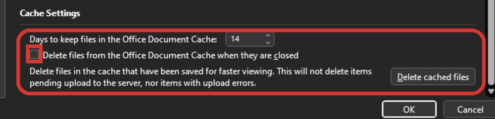

Hi All,
ESS workaround is a joke, will cause nothing but sync issues when working collaboratively.
See below for what has worked for us, with no negative impact so far, configured in word/excel options.. also available in gpo.
