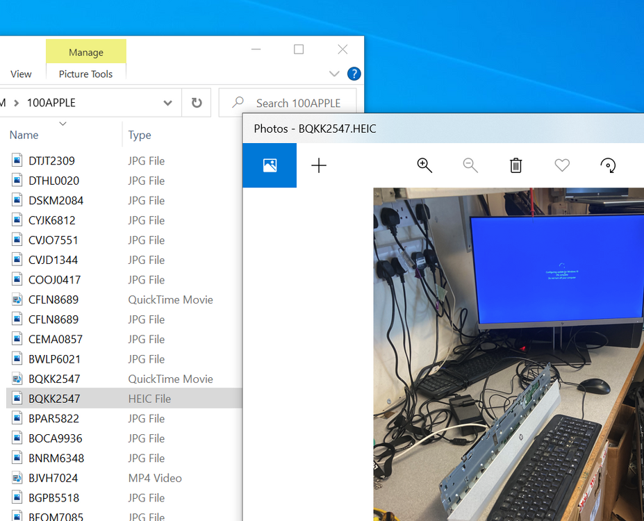

You cannot open HEIC image files that are produced by the camera on IOS devices on Windows 10. Having a look at options online means you either have to pay for an app or have a watermark on the image.
I am wondering if anyone knows of a free method to open these files please?

According to the IrfanView FAQ you need the following two extensions from the Microsoft Store to view HEIC files for free on Windows 10.
www.microsoft.com/en-gb/p/hevc-video-extensions-from-device-manufacturer/9n4wgh0z6vhq (see note below)
www.microsoft.com/en-gb/p/heif-image-extensions/9pmmsr1cgpwg
Note: If you are not signed into a Microsoft account you will be prompted to redeem a code to get the extension. It's only available for free when you are signed in.

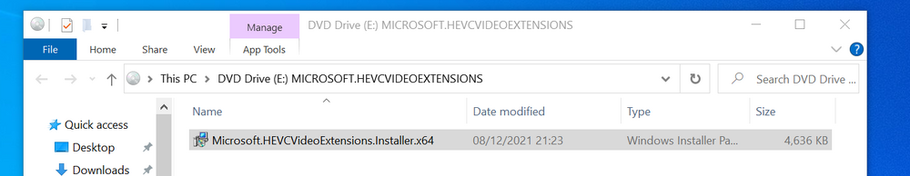

This is available from VLSC now
MSI download for HEVC Video Extensions
We deployed via SCCM and can open them now. Having some issues with Photoshop (cs6) however.
