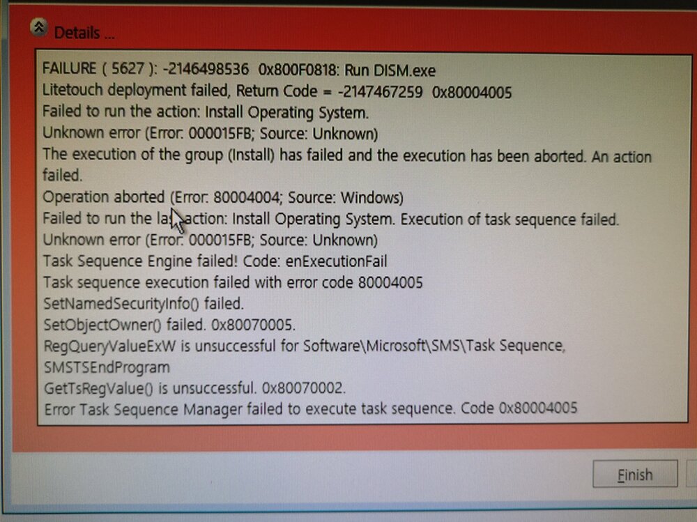

kennysarmy Posted December 14, 2020 Author Report Posted December 14, 2020 So deployment fails again with the error as above and still... All appears to be working: Running action : Install Operating System - 100% Then: Applying unattend.xml with DISM.EXE Then fails. This is with a new task sequence with no changes to the unattend.xml - just the basic one that's created when you create the task sequence. This is the answer file if anyone can spot the obvious error! OnError 0 1 .\Operating Systems\Windows10Edu20H2\Sources\install.wim /IMAGE/INDEX 1 OnError true en-US 0409:00000409 en-US en-US en-US true Balcarras School Balcarras School true Pacific Standard Time about:blank EnableAdmin 1 cmd /c net user Administrator /active:yes UnfilterAdministratorToken 2 cmd /c reg add HKLM\SOFTWARE\Microsoft\Windows\CurrentVersion\Policies\System /v FilterAdministratorToken /t REG_DWORD /d 0 /f disable user account page 3 reg add HKLM\Software\Microsoft\Windows\CurrentVersion\Setup\OOBE /v UnattendCreatedUser /t REG_DWORD /d 1 /f disable async RunOnce 4 reg add HKLM\Software\Microsoft\Windows\CurrentVersion\Explorer /v AsyncRunOnce /t REG_DWORD /d 0 /f 0409:00000409 en-US en-US en-US 0 "" 1 9 9 1 "" "" "" Default 1 l4244728 true true Administrator . l4244728 true 999 wscript.exe %SystemDrive%\LTIBootstrap.vbs Lite Touch new OS 1 true Work 1 true true true Balcarras School Balcarras School 0409:00000409 en-US en-US en-US \Drivers
kennysarmy Posted December 14, 2020 Author Report Posted December 14, 2020 I'm going to download the ISO for 1909 instead and go through the process with that base image to see if it's something specific to 20H2
