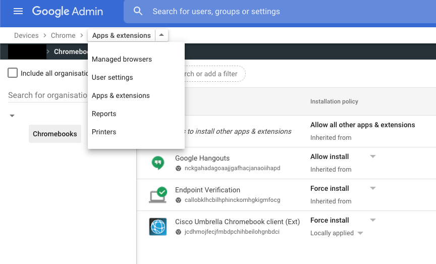

Jaan Posted November 12, 2020 Author Posted November 12, 2020 Another reply. Now i'm really confused Hi Jaan, Apps and Extensions have recently moved to a new page and there is no more User apps vs Device apps but simply apps and extensions applied to OUs so if you have an OU for DfE devices and an OU for Schools devices then set the extensions and apps locally per OU as you would like them to apply. And as per my previous response the Extensions and apps will be applied in the order of Device, Machine, User, Browser so if applied at the device level this will take precedence. Regards Dfe User Support
Primus Posted November 12, 2020 Posted November 12, 2020 Another reply. Now i'm really confused Hi Jaan, Apps and Extensions have recently moved to a new page and there is no more User apps vs Device apps but simply apps and extensions applied to OUs so if you have an OU for DfE devices and an OU for Schools devices then set the extensions and apps locally per OU as you would like them to apply. [ATTACH=CONFIG]59760[/ATTACH] And as per my previous response the Extensions and apps will be applied in the order of Device, Machine, User, Browser so if applied at the device level this will take precedence. Regards Dfe User Support Unless I have missed a major change they're wrong - extensions are still only pushed to users not devices.

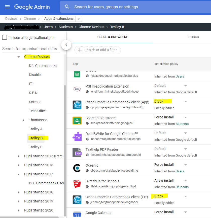

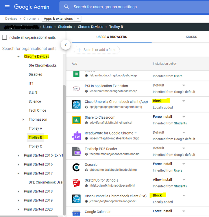

Jaan Posted November 13, 2020 Author Posted November 13, 2020 it may be that the block takes precedence, and applies to devices - should be an easy one to test either way but from what i understand it wont In fact that's what the Dfe are suggesting. However my after testing i'm still having the issue........ Cisco Umbrella is force installed at User level...... but Blocked at Device level on the school Chromebooks.... It still presents itself to the user on a school owned device. I'll make sure i've not missed anything and ensure the device policy has applied to the Chromebook. ---- Hi Jaan, If you set the Extension to be blocked on the Users settings for the School Chromebooks OU then it should block that extension on the Devices. Please do test and let me know as I can't test it on my side but i have seem this setup like this before. Regards Dfe User Support

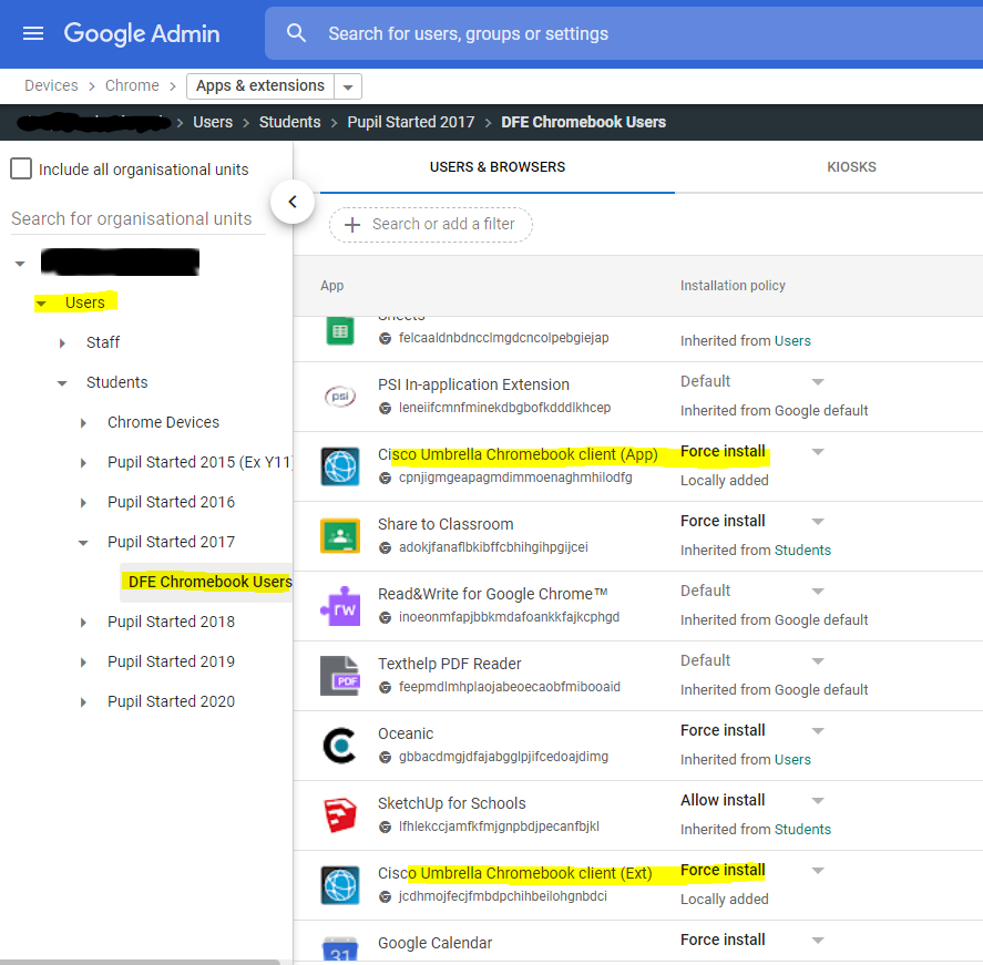

Jaan Posted November 13, 2020 Author Posted November 13, 2020 I've tried this again and its defo not working...... If also used chrome://policy to force both user and devices policies to update. Cisco is set to be installed at user level: Then it's blocked at device level; And yet when one of our DFE students logs into one of our onsite chromebooks...... the cisco app is installed and everything goes super slow. I Think the Dfe are wrong.
Primus Posted November 13, 2020 Posted November 13, 2020 I've tried this again and its defo not working...... If also used chrome://policy to force both user and devices policies to update. Cisco is set to be installed at user level: [ATTACH=CONFIG]59785[/ATTACH] Then it's blocked at device level; [ATTACH=CONFIG]59786[/ATTACH] And yet when one of our DFE students logs into one of our onsite chromebooks...... the cisco app is installed and everything goes super slow. I Think the Dfe are wrong. I think so too - extensions have always been related to users not devices.
