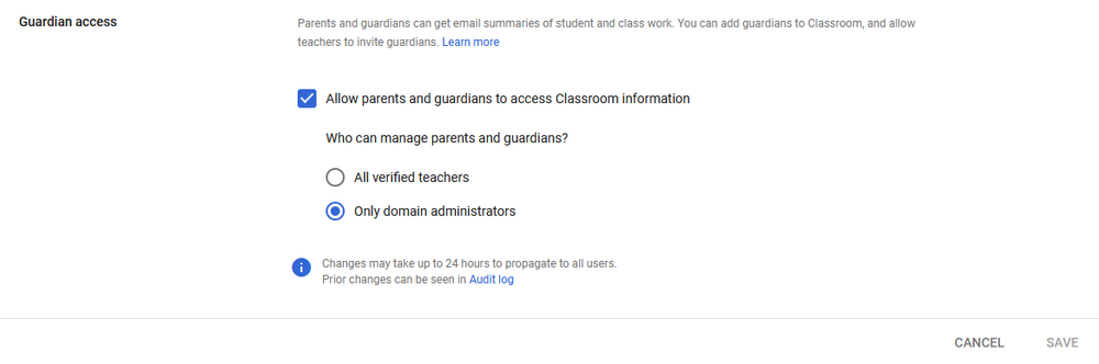

The default behaviour depends on your organisation type.
From https://support.google.com/edu/classroom/answer/7017326
You can turn on or off guardian access for your domain. Default behavior is based on school type:
For K–12 schools, access is turned on.
For higher education, access is turned off.
In order to see the option enable/disable guardian summaries in a particular class's settings page, you'd need to be an admin (provided you've got "Only domain administrators" set in the guardians option in the Admin console ).

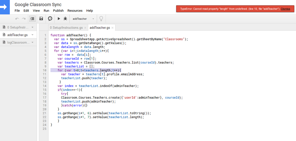

I've given it a go, ran script but then a minute later I get this.

I don't know if my phone is not loading the picture but I can't read any text. I can see that you've got an error. Can you copy the text that it says for me.
This is the error
TypeError: Cannot read property "length" from undefined. (line 10, file "addTeacher")
Dismiss
This is the line
for (var t=0;t
This is the error
Dismiss
This is the line
for (var t=0;tOk, is your classrooms sheet populated? Have any of your columns f or g populated with information? If it gets n rows in and then is blank there is some issue with the classroom on the n+1 row.
Are you running this from an admin account? If there is no info in f and g this is probably the problem.
Also if you have access to gam let me know. There's a one liner that would get the job done too.

So it turns out we have a teacher who has been removed from G-Suite but they still had active classes. These classes apparently cannot be removed as they have no owner, even as admin, so that is where the script is falling over I think..
Fairly annoying.
Fairly annoying.

Nope once you the teacher has been deleted, the class becomes a zombie! Can't have anyone added, can't delete, can't archive.
I've run that command with id instead of courseId and that seems to have worked! Thanks!!
