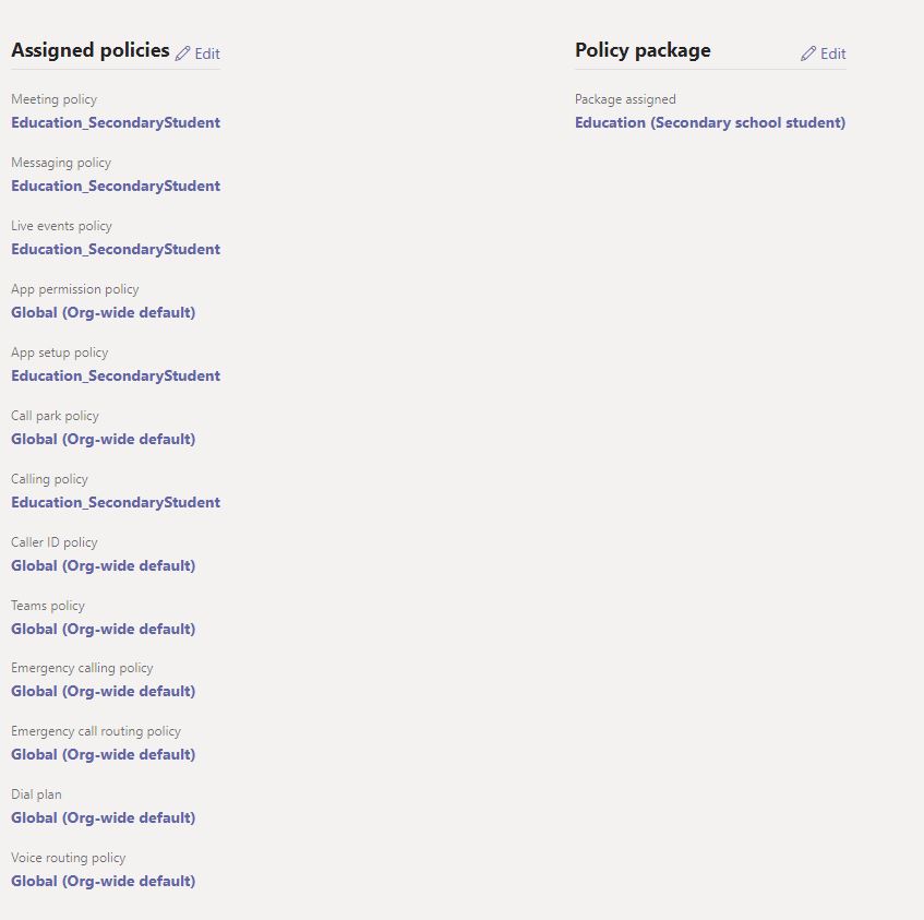

Can anyone share their powershell code with me as I need to push the Education (Secondary school student) package (policies) to all my students.
I've edited the Education (Secondary school student) policies with a member of SMT and we've tested with a test student everything is how we want it.
The polices for the test student look like this:
And I want all my students to look the same :) as currently they are all on Global (Org-wide default) - currently this is fine as I've not given any students apart from the test student a Teams licence.
Thanks.

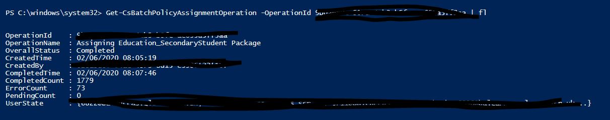

Well it did n't take as long as I thought, but it's returned with 73 errors.
Anyone know how I troubleshoot this further?
[ATTACH=CONFIG]58208[/ATTACH]
I think these were accounts that were in the AD group but did not have TEAMS licences or were not part of O365.
I've now since created staff policies and moved where necessary everyone off the Global policies where we felt there was a need to differentiate between staff and students.
