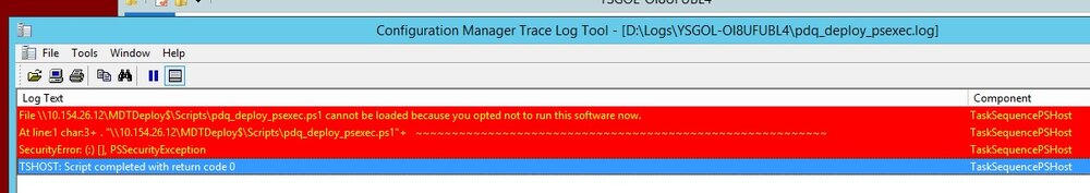

@davipton - I cannot even get the psexec script to run in the first place. I have a service account for building via MDT which builds machines without any issues. It's just the task sequence step for running the script which gives me:
Not sure why the build account cannot run the psexec script to then call the psexec commands.
Fed up now.
Gareth
Well -I've sorted it. It's a permissions issue so I've reverted back to using the delegated domain admin for testing and it all worked.
Now I need to work out why by Build Service Account will not work.
Gareth
