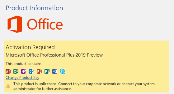

Zoom7000 Posted October 16, 2018 Author Posted October 16, 2018 Does anyone else see the word "Preview" on their installation? If it's the release edition, why does it say "Preview"
Norphy Posted October 16, 2018 Posted October 16, 2018 Because, according to that, you've not licensed it. I think that means it's preview as in Demonstration Version rather than Preview as in pre-release.
chazzy2501 Posted October 16, 2018 Posted October 16, 2018 @Zoom7000 No I do not see preview on mine. Mine is also still unactiviated
Zoom7000 Posted October 16, 2018 Author Posted October 16, 2018 Because, according to that, you've not licensed it. I think that means it's preview as in Demonstration Version rather than Preview as in pre-release. Interestingly, even though @chazzy2501's experience appears to debunk your theory, I'm trying to activate the copy using my MAK product key from VLSC and it won't accept it. Keeps saying... "Sorry, this isn't a Microsoft Office product key. You may be entering a product key from another version of Office" I'm definitely copying the one from the "Office Professional Plus 2019" section on the VLSC...
Zoom7000 Posted October 17, 2018 Author Posted October 17, 2018 So, it seems that when I posted the opening article, even though Microsoft had "released" Office 2019, they clearly hadn't updated their servers, because my XML decided to download the preview edition. I just re-downloaded it using the same XML file and now it's no longer showing preview. It also now accepts my VLSC product key.
