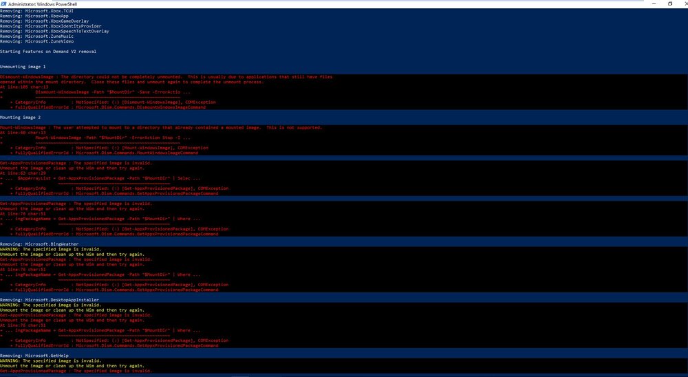

Thanks for your help guys. I couldnt get the script to run locally on my machine so I ran it in a completely fresh install of Windows 10 on a VM, I was then able to run the script. It seemed to be running ok and I could see apps being romved but when it came to doing hte unmounting I got alot of what can be seen below. Is this normal or not?
