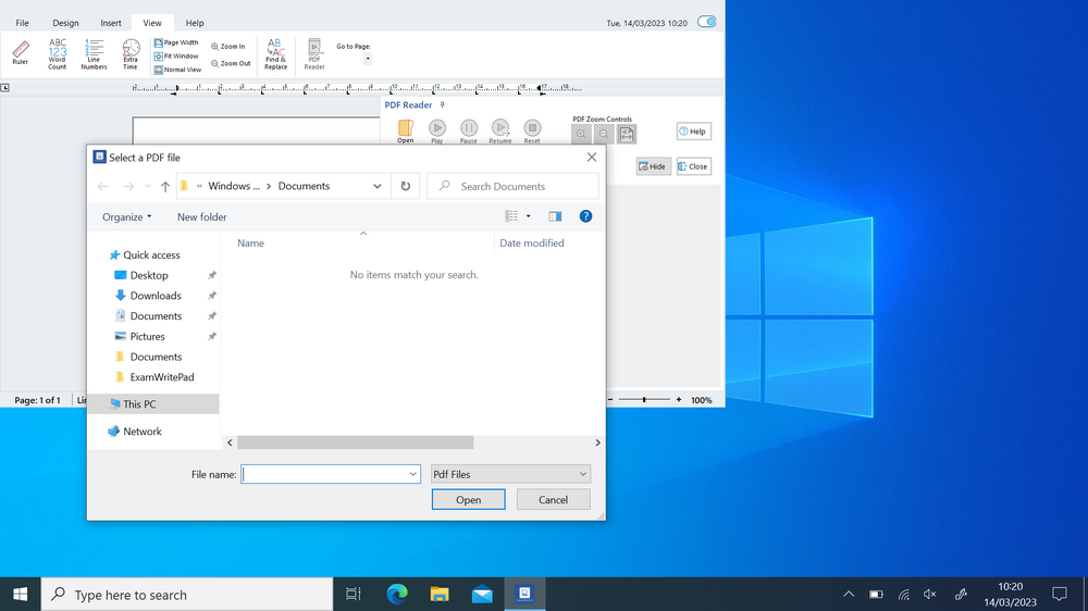

When using the PDF viewer the screen is no longer in full screen.
When you close the file explorer window it doesn't revert back to full screen.
Just a bit of a bug...
[ATTACH=CONFIG]68322[/ATTACH]
Looks like you have the unreleased version with the PDF readAloud, oops. Did you start the app in full screen mode? This doesnt happen for me, it stays in fullscreen mode... strange?
Yes we start the app in full screen mode.

ok dorsnt happen for me so it must be something else. Can you send me your config file and I can test it my end.
