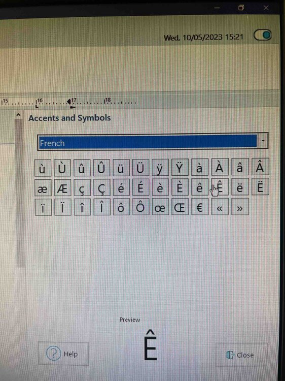

Hello,
Is this functionality still in ExamWritePad? We cannot get this to work in ExamWritePad but can use the exact same shortcut in Word, implying it's not a keyboard issue.
Hello,
Yes but instead of CTRL you need to use “ALTGr” key.
The ALTGr key also works in MS Word too.
Sorry but that doesn't seem to work right, if I hold the AltGr key and the Accent Grave key ` and press any of the letters, it'll produce a ÁÉÍÓÚ instead of the ÀÈÌÒÙ. If I try AltGr+Shift+^, it'll still produce ÁÉÍÓÚ instead of the caret accent. Any suggestions?
Yes seems like an issue that needs sorting out. The text control component I use hasn’t implemented these keys fully. Therefore I will have to come up with a workaround.
For now just have the pupil keep the accent and symbols(Insert —> Accents Symbols) list on screen so the can click the corresponding button to insert the character.image-2023-05-10-15:21:10-027.jpg

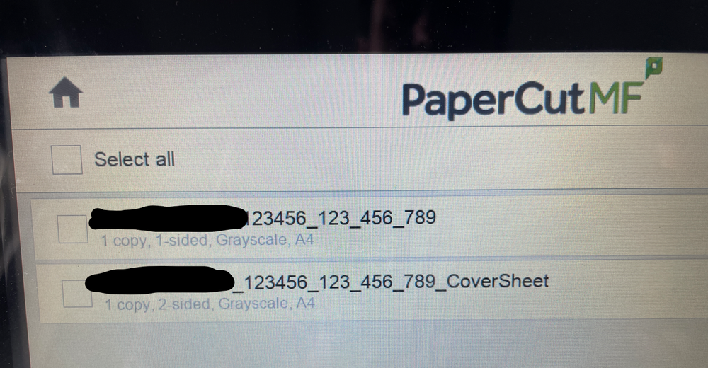

Regarding the automatic cover sheet (which is an amazing feature!), is there a way to get this to be within the same print job? Currently when using PaperCut follow-me print, the cover sheet appears as a seperate print job, please see image below. Thank you for an amazing piece of software!
[ATTACH=CONFIG]69017[/ATTACH]
Thank you for your great comments.
To answer your question, the short answer is no because of the processes that go on in having to generate the coversheet. The printing and generate of the document are separate for programmatical reasons beyond my control sorry. I have tried to offer this but it’s just far too messy and not 100% reliable.
One thing we mentioned a while ago is some way of changing the order so that the cover sheet comes out before the main page on papercut. Was this something that was possible in the end @ass17 ? Also thanks so much for the software
