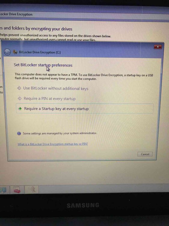

Whilst testing I have no other option but to use a usb. the pin option is grey out.
the USB acts as the TPM chip and is required for devices with No TPM chip on the motherboard.

As you've noticed, Windows 7 doesn't support Bitlocker with PIN alone when there's no TPM. That functionality came with Windows 8. For Windows 7, Veracrypt is probably the best solution.

Yeah iv done all that but when I come to turn on bitlocker it only offers the option of startup key
I agree I would very much like not to use usb if I can help it
The other two options are greyed out

Yeah that was my understanding from 8 onwards you can use a pin.
I was hoping I was wrong.
Looks like a USB key it is or veracrypt
