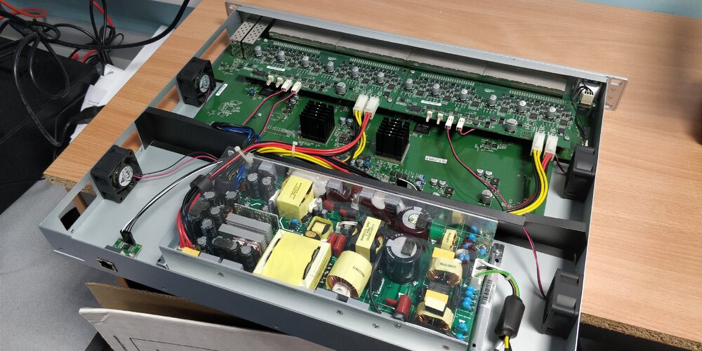

We use a trusty hp z5406 as our core but with a mix of unifi and hp edge switches. I have to say the unifi easily keep up with the hp switches with the added advantage of single pane of glass for stats & config. 48 port poe can be quite loud. The fans can be swapped out for these https://www.scan.co.uk/products/40mm-noctua-nf-a4x10-flx-low-noise-fan according to this https://community.ubnt.com/t5/UniFi-Routing-Switching/Switch-US-24-250W-Fan-Level-amp-PoE-Settings/td-p/1679256

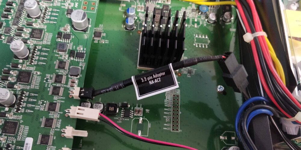

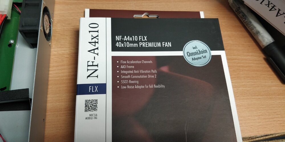

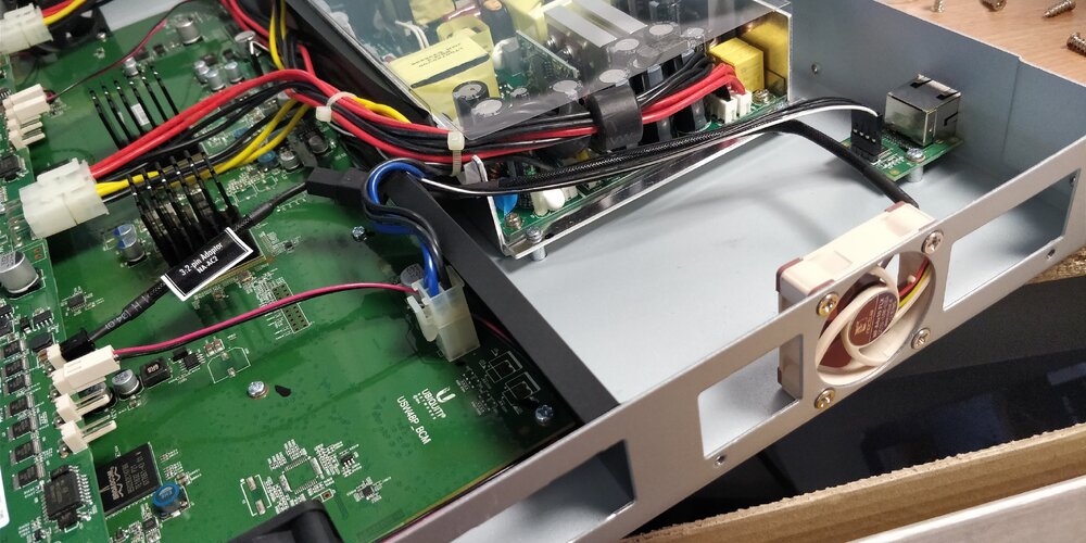

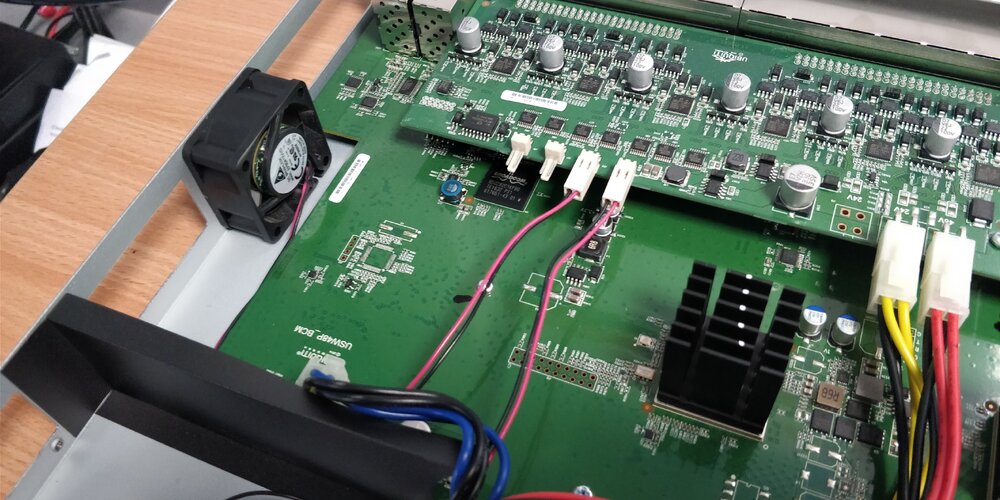

I have just completed this on one of our Unifi 48 port POE switches for anybody that is interested. Cost about £48 but the switch is completely silent. Temp went up from 52c to 56c but all seems fine.
Before - https://drive.google.com/file/d/17Op3bjyi8NDutfLn2bwzeaTA7rSBrJ8Q/view?usp=sharing
During
After - https://drive.google.com/file/d/1wcKlJ6ESOgdK1RS35C6rRpHenhjlNoHr/view?usp=sharing
Edited by markwilfan
