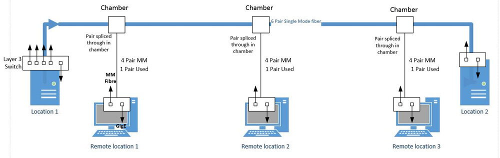

  7. Hi, There are quite a few ways that you could achieve your goal though you can narrow the options down based upon budget, geography and terrain. A simple approach would be as shown in the diagram, when the civil works are done put in chambers and splice in and run out to the remote locations. This would create a hub and spoke network centered on one of your end locations using a L3 switch. You could run the whole network routed by putting L3 equipment at the end locations or L2 and terminate the VLAN's on the 'core' later 3 switch. You could also run the whole lot as one flat network but you'd have broadcast traffic everywhere. You could also create a logical ring using the same physical setup but this would only protect against equipment failure at one site - it would require more kit and you'd be best off with two core switches. As dhicks says, you could also run a physically separated ring between the locations but your dig costs could be quite significant. If the terrain is flat and your sites have decent elevation then you may get a lower cost solution from point to point microwave - that will happily scale up to Gigabit speeds should you need it. Hope this helps
