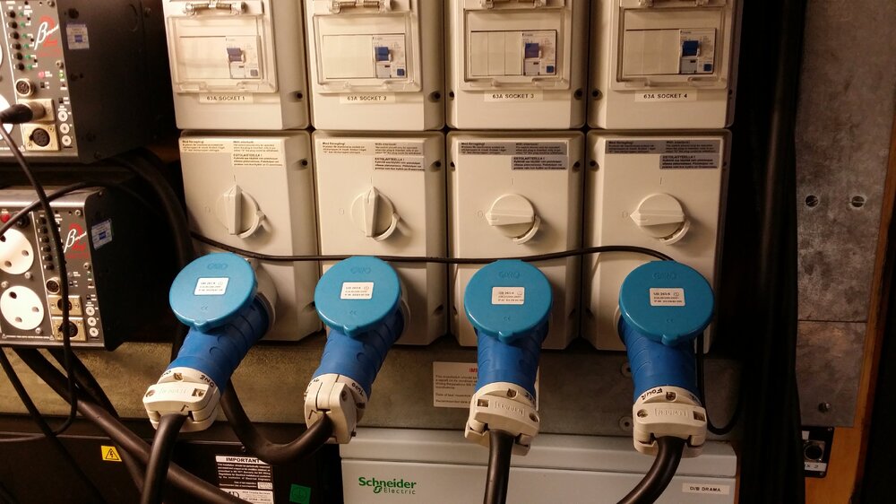

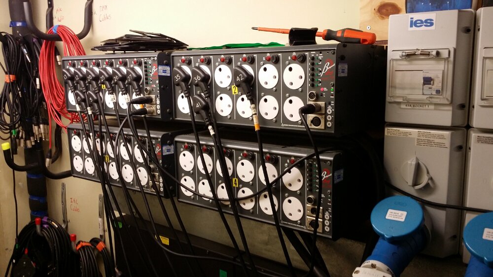

newpersn Posted September 12, 2017 Author Posted September 12, 2017 Ok. Been thinking and had a quick look. There is 4x 63a power thingys. They are connected to the dimmer packs. Yes there are patch board. Would have to get electricians in to put a few sockets in by the patch boards. Had a quick look online and looking at £100 per unit.
3s-gtech Posted September 13, 2017 Posted September 13, 2017 For power, we got our 32A sockets for the dimmer packs converted into an array of 13A sockets on separate rings. Then we could use 13A fused to IEC C13 leads to send 240v to the bars for each light. Cheap and easy.

Andycat Posted September 13, 2017 Posted September 13, 2017 For power, we got our 32A sockets for the dimmer packs converted into an array of 13A sockets on separate rings. Then we could use 13A fused to IEC C13 leads to send 240v to the bars for each light. Cheap and easy. Similar...
SamanthaD Posted September 13, 2017 Posted September 13, 2017 I'd be worried about the bend radius on that cable coming out of output #2... Betapack 2's are perfectly fine, better than the Strand Tempus dimmers I was running at my old place....
