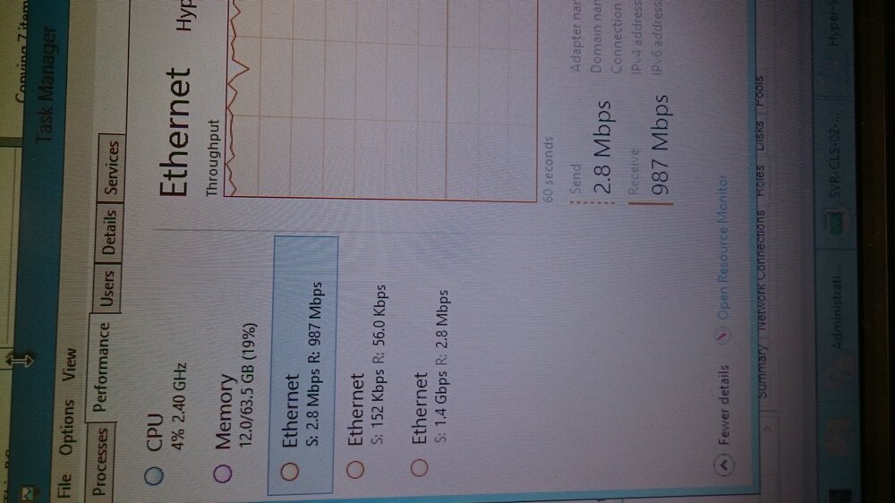

[ATTACH=CONFIG]41904[/ATTACH]
And people still say "hey the networks a bit slow today"
I think to myself, no it's not its the crappy website your using that looks like it was made buy a guy in his shed! ;)
Nuff said...
This is between a backup server the the other side of the site and one of our cluster hosts.
(the 1.4gbps is the 10GbSAN connection)
Task Manager shots look more impressive :)
