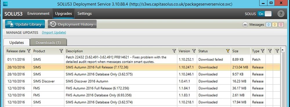

This is sitting on my SOLUS this morning though, full release is there for me I think - is that what you're looking for?
I don't have SOLUS automatically install anything! I don't trust SIMS, CAPITA or SOLUS enough to be honest...
[ATTACH=CONFIG]39625[/ATTACH]
Yup thanks! On the phone to them now. 95% of the time the auto deployment works great and can't fault it however in this case the Autumn DB patch has appeared and applied but no full release patch on mine and check for updates shows nothing either so can only presume this is what causing the DB Incompatible error.

My SOLUS clearly shows an entry for a SIMS Autumn 2016 Database Only (3.62.574) Release date 12/10/2016, but there is no corresponding full release.
Only on the 28/10/2016 is there a Database release (3.62.575) and a full release (7.172.36).

So here's a further update nice and simple.
I just backed up the Solus3 DB (yeah it's fubar by the looks but what the hey!) and restored last night from Veeam, god bless Veeam...!
So now I have last nights Solus DB live again from 01:30 (technically today but I'm tired now, gimme a break!) and it's all working again as per this morning meaning I have the Autumn DB patch in there and successfully deployed according to the GUI on my DB which is true and no Full Autumn Patch.
I click check for updates and it shows nothing to download so guess I now need Capita to authorise the patch again (3rd time now) however technically the files are downloaded, extracted and ready in my deployment repository as I only restored the DB.
All the clients are now showing online again and I can remote into any machine and do the client update application manually to trigger a pull request for the patch but it says it will download and install the summer patch (obviously because that's what it thinks is the latest patch it has is, be interesting to see if it downloads the Autumn patch in the repository thinking it's the summer, will test...), have used the agent to download the install the FMS Autumn patch onto existing clients that had that so the deployment are working again.
Ok so I can't update the clients as Solus3 agent reports there is no update that matches the DB version so there is some signature check in the Solus3 agent and DB entries which is good.
I will now have to get the full update again tomorrow and then try deployment again and see if it Fubars Solus3 again
So this morning everything is resolved and the patch is deploying to Workstations and Installing as it should.
I called Capita up again first thing and asked for the patch to be re-authorised, as soon as it appeared in Solus again I Simply deployed it and Voula off it went!
As of typing I have 90% of the workstations updated now as should within the space of 20 minutes.
What was the overall issue? Fcuk knows... The workstation patch not being there was 1 and needed re-authorising for whatever reason and then 2 Solus3 decided to spas out during deployment and screw everything over at a database level (Solus3 DB not SIMS).
Simply restoring the DB back to the night before, having the patch re-authorised and deploy again and all is good.
