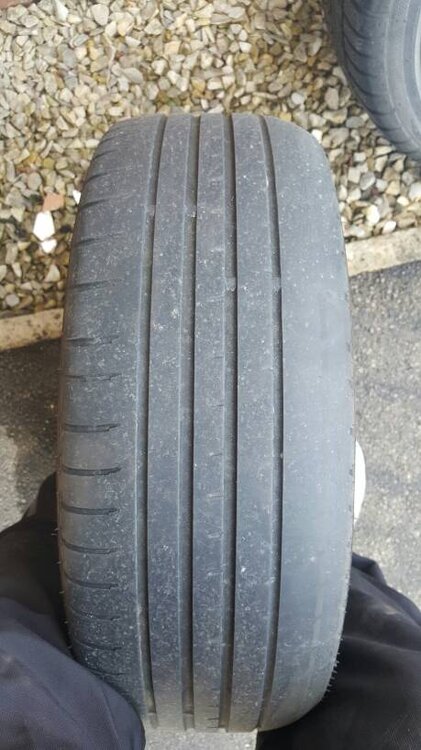

I think ive found the problem..
First picture existing fronts (accelera alphas), second picture existing backs (accelera deltas). Signs of wear on the inside shoulder of the These have now been switched round and have been told i need to replace the alphas and get tracking done on the front. The deltas were originally on the front and can see signs of wear on the inside shoulder.

Get them to check wheel before putting new tyres on
Just incase its buckled? I showed the rims to a neighbour and he was very surprised to see how much weight was on the inside of the rim. Maybe this is having an affect?
A buckled wheel will show up when it's balanced, lots of weights added and it's probably not straight. It's easy to find if there is any wear in your mechanicals that are causing the uneven tyre wear.

It does just look like the tracking is out. Only takes a little knock to put it out. Those new tyres will wear the same if it's not sorted soon.
Get it tracked up, aligned up and get them to check for any buckled wheels. I used to get my car tracked at 3 monthly periods as I used to drive a lot of bad roads and the combination of that and low profile tyres used to kill me but keeping it tracked was cheaper than replacing tyres that had not worn evenly.

Defo tracking is out which is why your tyre is worn at the edge also cheap tyres never help I run some mid-range ones my tyre guy recommends and they have great life on them so I trust him they are usually Cooper that I had on my Golf maybe Cooper on the current 4x4 as well but cannot remember as its a while since i bought some but they are fine but a bit noiser at high speed on the motorway than the Goodyear sport tyres it had on it when I got it.

I popped to the garage last night, luckily i know them, my dad knows them, i work with their mum, etc etc. Anyway, we spent about 15 mins looking at the problem. The tyre its self looks and feels ok. We compared the left to the right and found what looks like the left is a little buckled on the inside, i might have hit a pot hole :( but i have been told ford alloys are very soft (by a ford mechanic that i know). So, these rims and tyres can stay on the back and the deltas can stay on the front. I road tested again at 70 and there was no wobble, it was such a dream :).
They said that tracking is out a little bit but nothing to worry about. Ill monitor these tyres and see how it goes.
