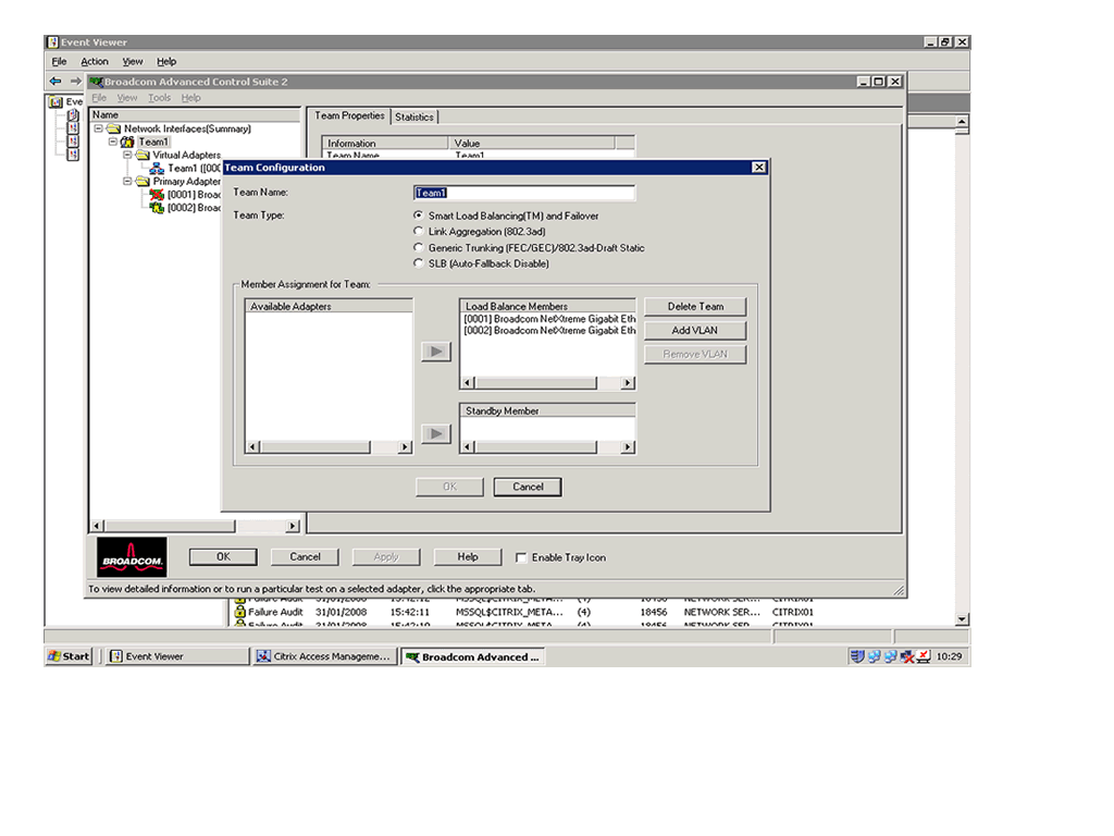

spc-rocket Posted January 31, 2008 Report Posted January 31, 2008 1) Are they intel cards? If not don't bother (just my personal opinion ). 2) Do your switches support 802.3ad? I think the Broadcom NetXtreme cards are okay as well with TOE functionality. Ash.
DMcCoy Posted January 31, 2008 Report Posted January 31, 2008 HP do decent cards too. I think the Broadcom NetXtreme cards are okay as well with TOE functionality. Ash. As long as they have something as nice as the Proset utilities then I'm sure they will be fine
