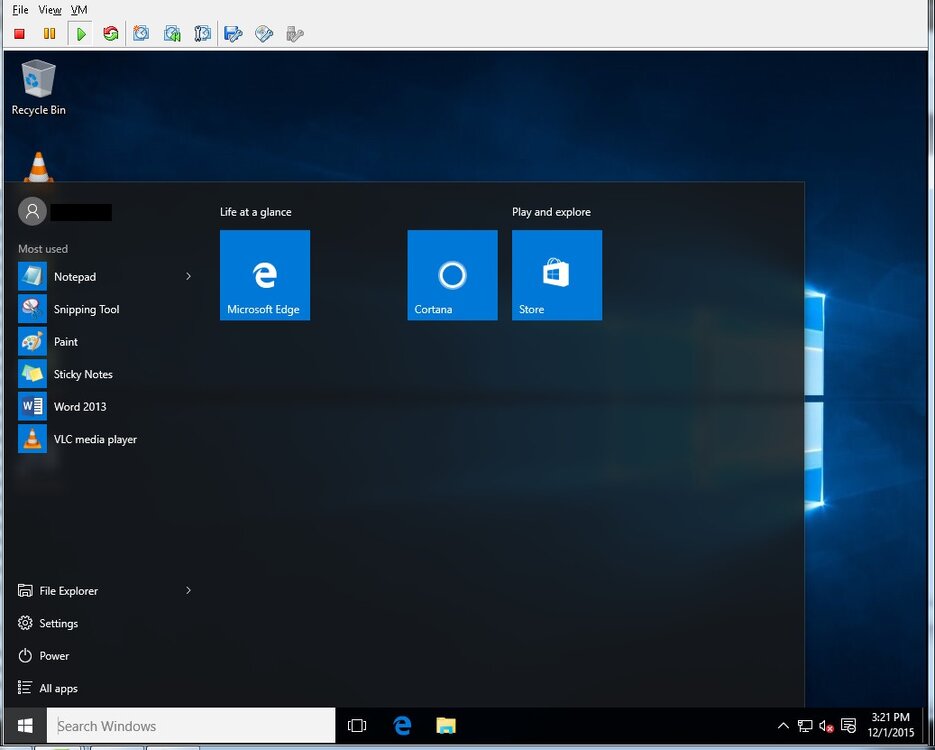

It doesn't need to be this complicated. Load a fresh install of Win10, when logged in as the newly created local admin (don't create any other accounts yet) run the two Power Shell commands that were linked to in the second post of this thread. Only things you need to watch out for is to run Power Shell as an administrator (right-click, run as admin) and use the version of PS that matches the OS architecture (32 or 64 bit).
Bam:
[ATTACH=CONFIG]33566[/ATTACH]
First logons for users are nice and speedly without the crap.
